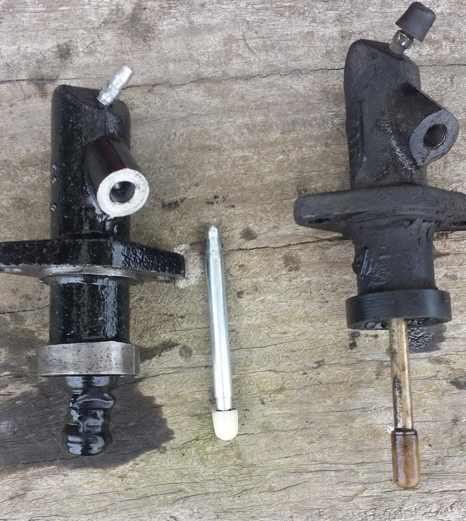

          finally found some time to get under the car again!
          Removed the slave cylinder again and as you've mentioned, the rod has fallen out of its socket from the slave unit.
          The rubber boot around the rod has given its self a small split. Will this cause issues with sealing it?
          After reinstalling the slave again, i still had the same issues. seems like it must be a seal.

                  Thanks for the help guys. Sorry it's been a while but I thought I'd post up my solution for anyone else with the same issues.
                  I had the car towed to mechanics so that I no longer had the headache. He replaced my new slave cylinder as it had broken an internal piston seal after my first failed attempt with a heavy duty slave. He then removed the new rod and dropped it by a engineer to fab up a longer rod by an extra 10mm. He had this done because he believed that I had actually bend the clutch fork plate when the original slave had killed itself.
                  He then bled the system and topped up the fluids and I haven't had any issues with it since.
