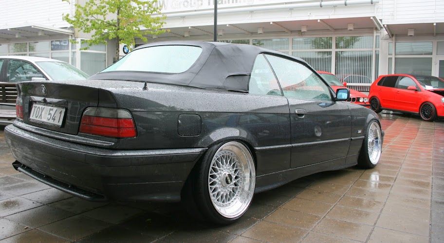

    Can anyone tell me what size wheel rubs inside of the "wheel housing" in the rear?
    Does for example 10x18" with offset 45 fit?

      This is what they will look like vrs when i had style 44s on in the rear.
      The 44s fit with no spacer in the rear and needed 15mm in the front.

        you will need to roll the arches im running 17x10j et20 rears et13 17x8.5j fronts had to cut the inner edge of the arch but before that i ran some style 32s but the lipped versions and i got away just rolling they were

          Borrowing the thread. Will 11x17+19.6 fit in the rear on a e36?
          The arches are rolled and iv'e pulled it a little.
            Can someone help me?
              Yes with skinny tyres and shed load of work and camber
                I uesed to run 9.5x18+13 7* negative camber
