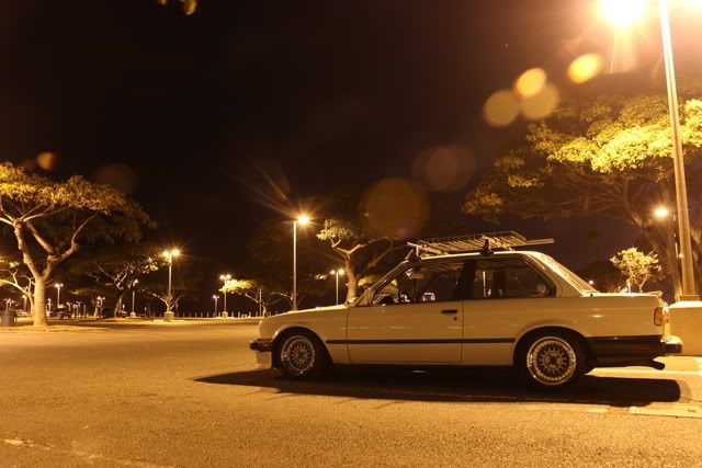

                        Since I'm looking for a similar answer, if there are any e30's here that has acquired "slammed" status, can you let me know how you go lower in the rear?
                        My fronts are completely fine and I have AST 4100s, but I just can't seem to go lower in the rear. I either have a 4" or 5" inch springs, and they're pretty stiff (I forgot the numer). I tried putting them on without the adjuster and it scared me because, every time I lifted my car up from the rear, it looks like the spring would fall right out.
                        Any idea's? I just want to go a tad bit lower for Hellaflush Hawaii, and was wondering if you guys can help me out.
                        Here's a picture
                        Sorry for thread jacking.
                          I don't know about how your coil overs are, but with my GC spring/ Adjustable Koni combo the rear shock didn't have enough downward travel to let the spring out, even jacking the car up. Short of buying a new spring, taking the adjuster out is your only option.
                              Here's a picture
                              [IMG]http://i244.photobucket.com/albums/gg4/KaitoIshida/IMG_1865.jpg
                              Shouldnt have any problem running just the spring as long as your not gonna rally it on the way,, I know 4-5 guys here in iceland that run the rear springs with no adjuster..
