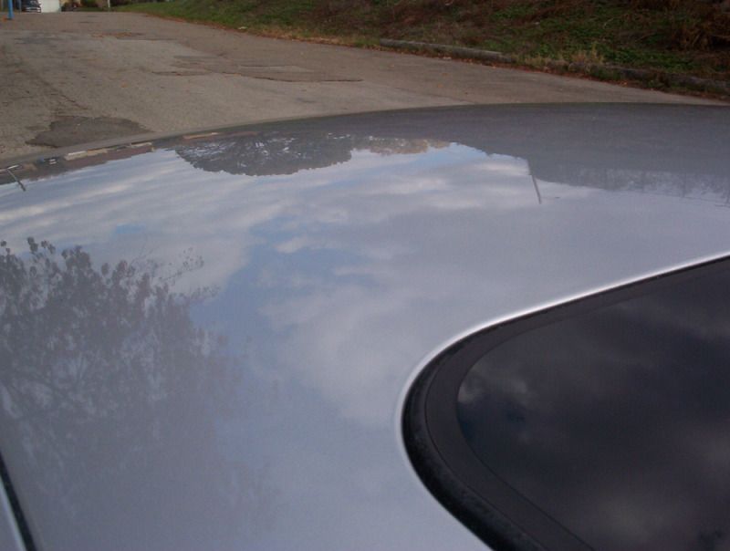

Anyway, on to the pictures. Not very impressive as it is a real pain to capture reflections on silver paint on a mostly cloudy day. If the car was a darker color, I'm sure the work done would be more apparent. Car is a 2001 with 109k miles.
