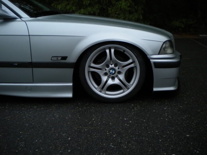

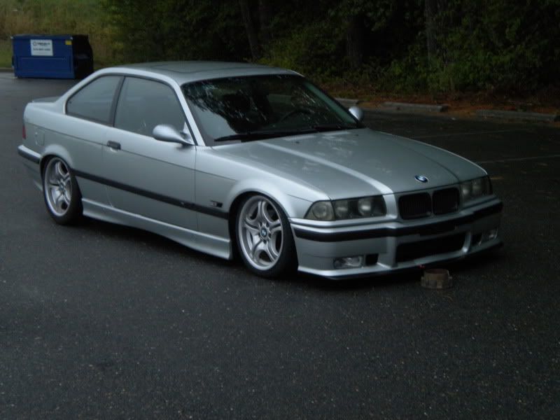

      Updated pics for clicks
      An Idea of how low I am ^

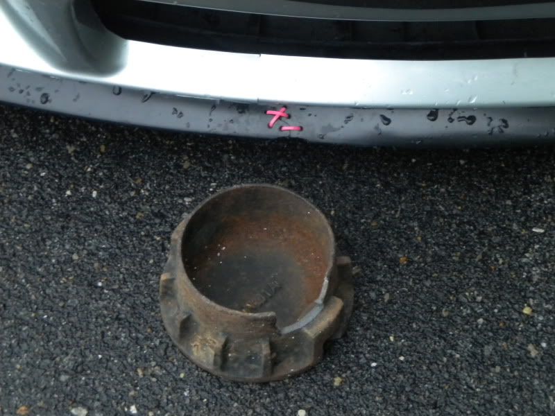

      And this was laying in the middle of the road last night, not covering a hole or anything, just waiting for a low car to come along and break its bumper.
