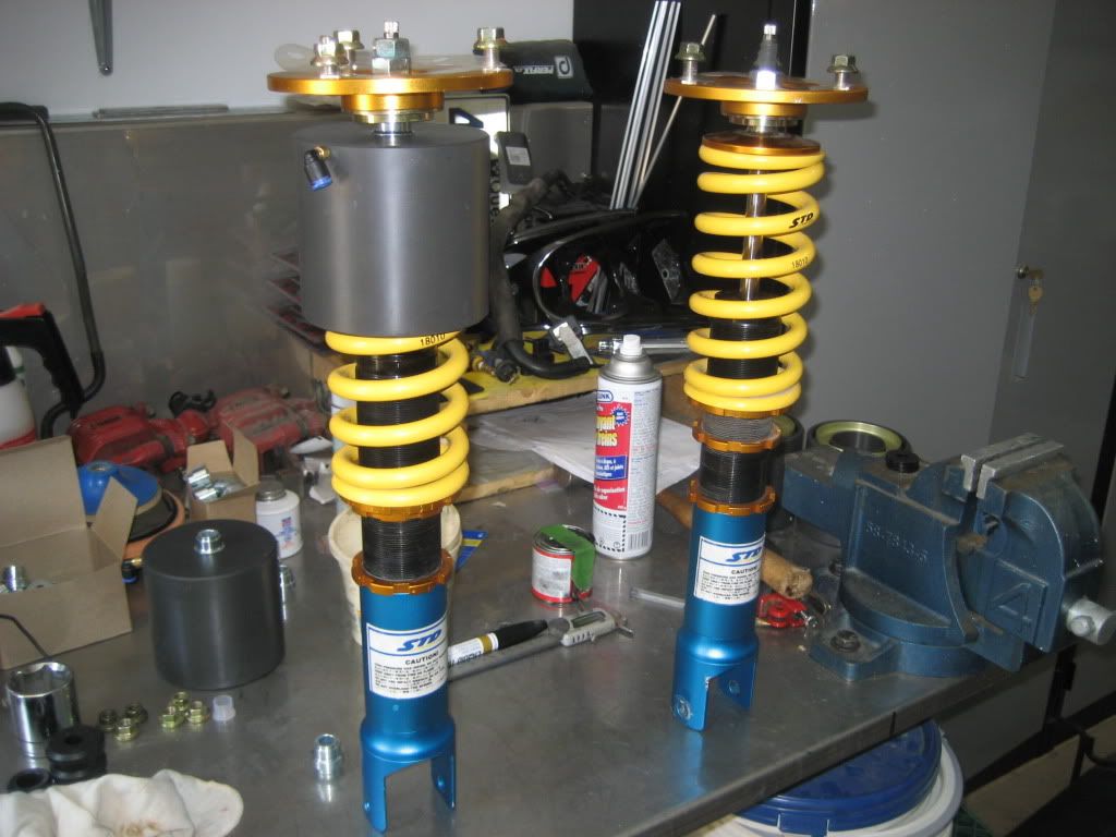

      Maybe what you want is "air cups"? Little air controlled pistons that mount on top of a spring and give you 1" or 2" or 3" lift when you need it, otherwise they run without air and give the coilover full control.
      [IMG][/IMG]
