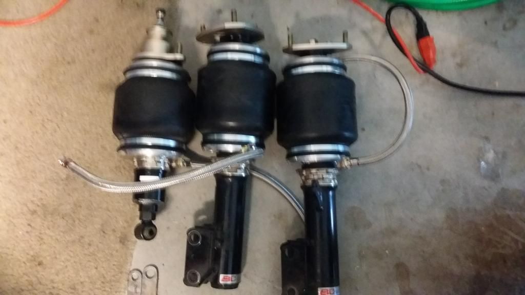

    I'm running air house 2 over bc coilovers in the rear, and aero sports in the front. I'll attach a picture below to see if anything looks out of the ordinary.

    Here's 3 of the 4. I'm not sure where the 4th was in the picture. Before install I reseated the bags so they sat flush against the bottom rings, rather than sitting like pictured.

    When it's installed do the top hats sit flush with the top of the bag?
        For the rears no, it takes a good 40 psi for them to meet the top hat without the weight of the car on them. Do I need to crank the bags up further?
        The tops sit rear nice, and I don't think the sounds are being caused by the front. I really need to figure out why the rear is making all these sounds.
