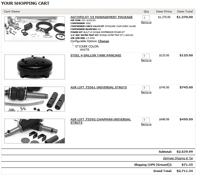

    Okay, after deciding I wanted to lower my Saab I was going to go coilovers, but after awhile I decided to go big or go home. I want to build the first bagged Saab 9-5 (to my knowledge) ever. But, I'm totally new to air ride, so I have a lot of learning to do. Obviously there are no pre-made kits for my car, so I'm going to be building everything myself. I'm still just in the planning/brainstorming phase. I've been doing a bunch of research and decided I definitely want autopilot V2 management all hidden away in the spare wheel well.
    This is kind of what I'm looking at here:

                      More questions!!!! Sorry.
                      So I have a couple questions for the front.
                      I was thinking about not wanting to go through the hassle of fabbing the mounts with the builder kit, and about using a pair of Koni Adjustable struts that are already made for my car and placing an Aero sport bag over those. It would be essentially the same thing right?
                      Next question, what is the difference between these two aside from the extended height? Or is there any? And if the above plan is solid, which you would suggest for my setup?
                      Sorry for my ignorance, just want to get this all figured out! Thanks.

                        You can definitely just slap an Aero Sport on Koni struts that were made for your car. By slapping them on, I mean you have to weld the lower Aero Sport bracket to the strut body but that's not the end of the world. I don't recommend welding on struts (for liabilities sake) but I've been told that when welding on struts, make sure you don't weld for anymore than 10 seconds at a time and let it cool fully before starting another 5-10 second weld.
                        The Aero Sport and the Air House 2 Aero sports are really similar but like you mentioned the difference. is in the extended height. The pressures will also be different when comparing the bags at the same extended height. The Air House 2 Aero Sports, since they are a smaller bag, will run at a higher pressure than the original Aero Sport. For your car, I would recommend steering away from the Air House 2 Aero Sports. I think it would be a little too stiff.
