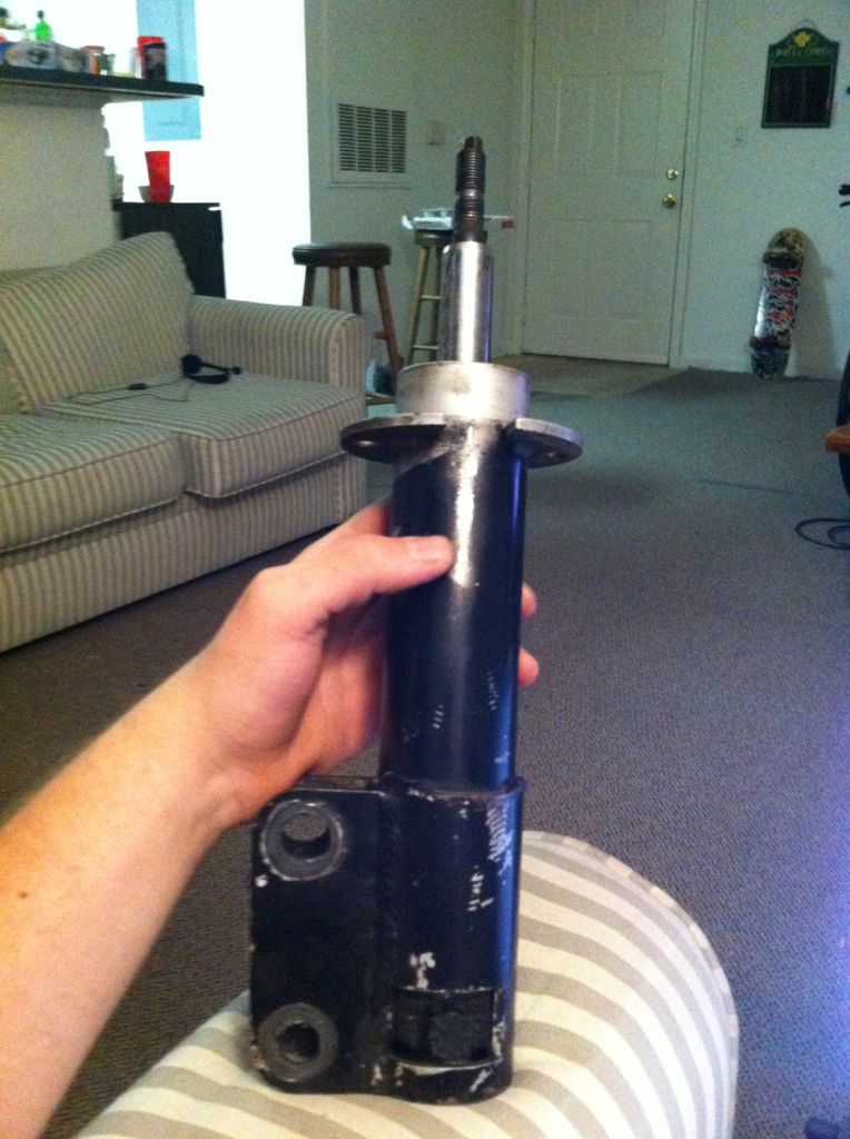

                    Sorry, when I say shock i need to be more clear. Its a bag strut combo for the front and back. And i'd say the most comfortable ride height i've found is about 2 inches lower than stock but it just doesnt feel right. They arent mushy or wobbly feeling, they actually feel like theyre too stiff. I'd describe the bouncing as if the bags werent dampened at all and were at a high psi. Something like if you jumped on an over full air mattress. Just a stiff firm bounce that isnt controlled. So, ive tried less air pressure, firmer dampening, higher air pressure, all sorts of stuff. I'm starting to wonder if the struts need rebuilding
                      Okay, I took everything off of the car. 3 out of the 4 struts are bad, 1 is completely blown. Is this something that I can rebuild myself? Or can they even be rebuilt? Im out of luck if not
                        pic of the struts you're using?
                        If they are early airlift then they're useless.
                        Although from what you were describing, the height you were driving your car at must have been topping the shock out aka over extending the shock. That would have also contributed to them blowing out.
                        Im guessing they were universal struts?

                          I don't think I was topping them, I rode around pretty low. And I'm not sure if they're universal, I think they are old airlift struts. I really haven't been able to find any info on them
                            Yes, that's the old Air Lift style strut, back when it was Easy Street. Part number for the kit is 75590:

                              It sounds a little bit like what I experienced with my AirRex kit, especially in the rear. In attempting to find a soft ride (that kit rides really stiff in my opinion), when I set the damping to full (or near full) soft, there would be a lot of really fast up-and-down motion while driving. Definitely at this point the shocks were under-damped and every little bump set the car oscillating up and down. So with your blown shocks this is what you were experiencing.
                              The downside for me was that when the damping was set appropriately to control the spring rate of the air bags, the setup was too damn rough. I bought air ride for a smoother ride than coils, but with a baby in the backseat we couldn't take it.
