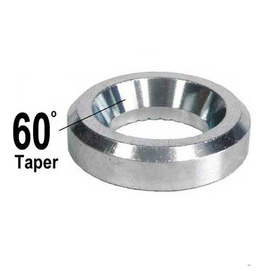

          I think what I'll end up doing is buying the conical seat inserts, in addition to hubcentric rings. I don't like the idea of a wheel centered by lug bolts, either. I'm getting too damn old to risk a wheel taking a walk on me. Thanks for your input, per usual!

            These:
