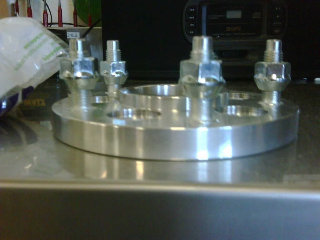

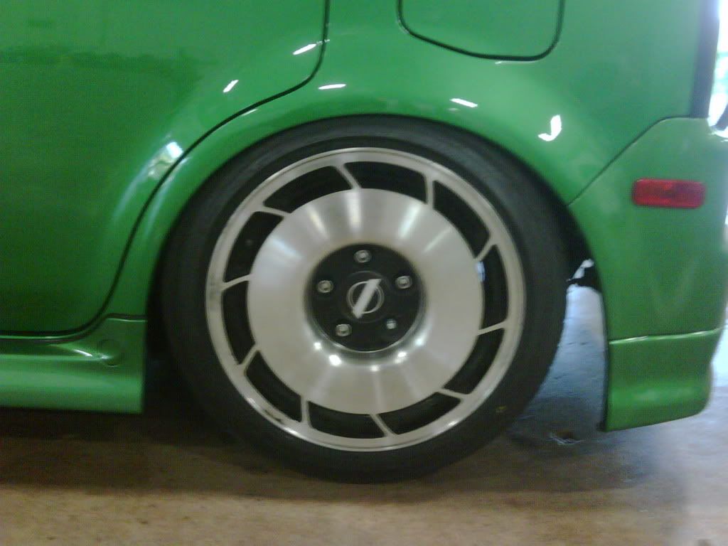

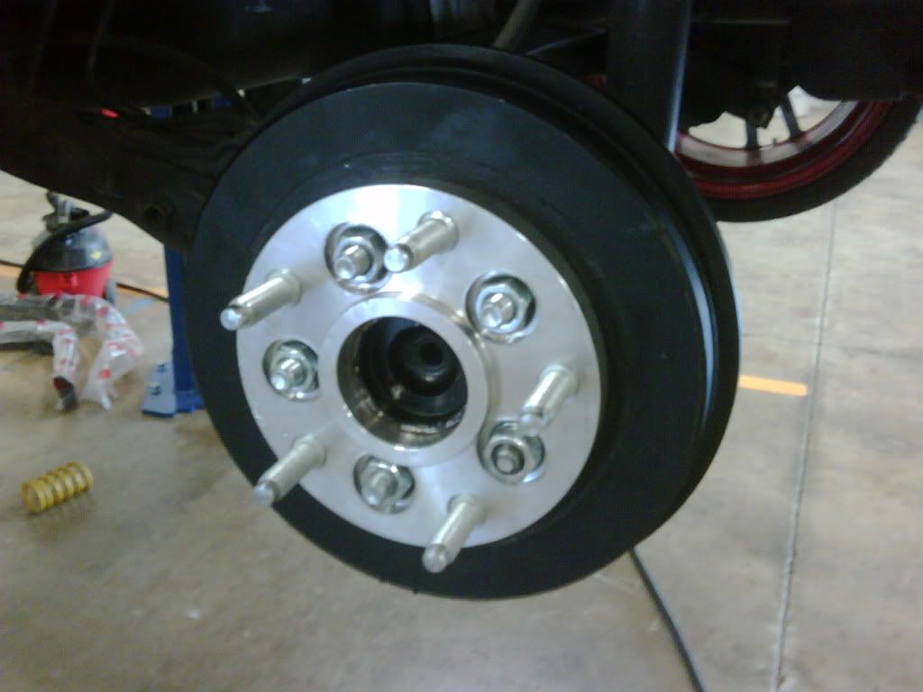

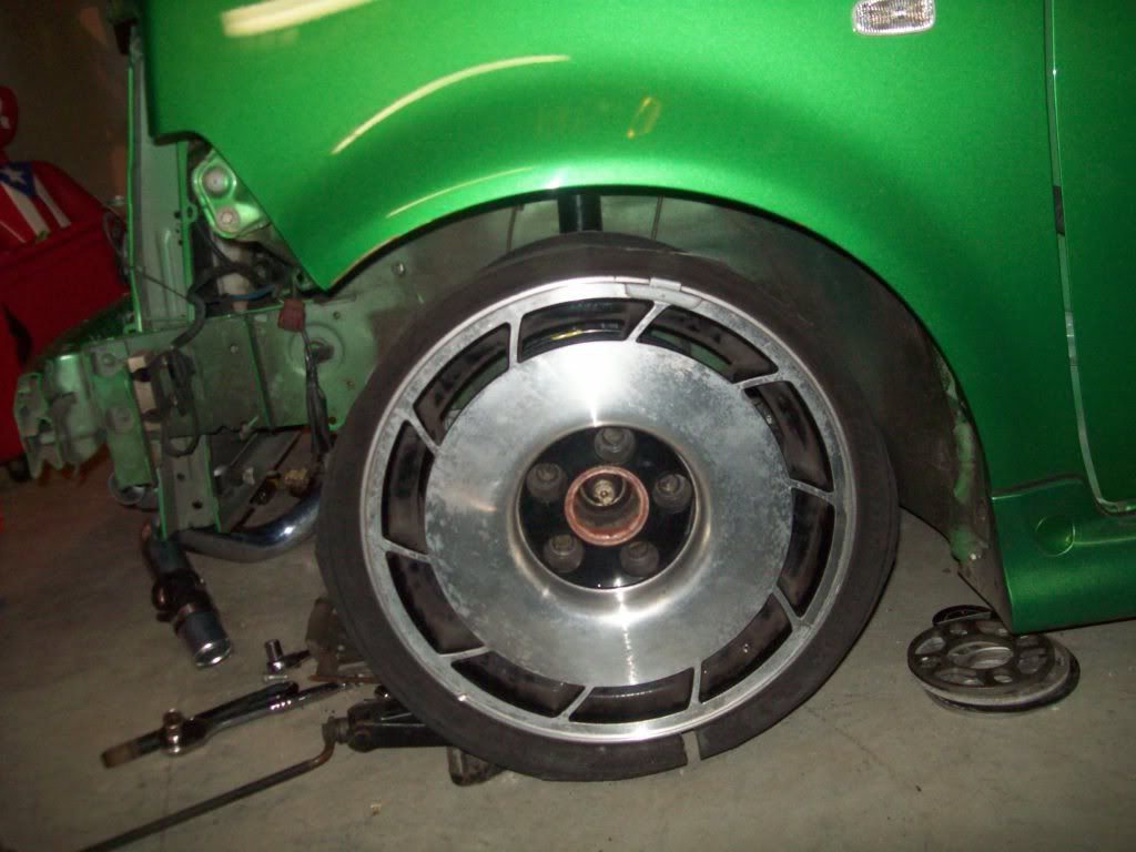

Now first of all i am from Milwaukee, not exactly the stance capitol of the world, This conversion is using all 1st gen XB parts(no Tc or Gen2 xb parts),
i have done alot of research and testing before i attempted any thing.

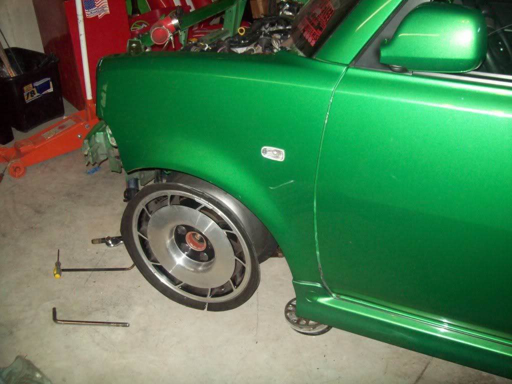

What i am doing- Making new front struts so the car goes lower but still has travel

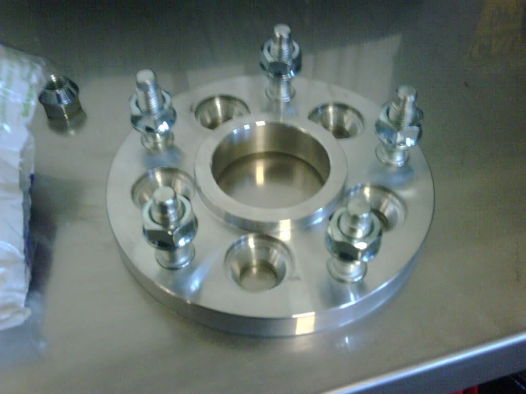

Drilling the factory hubs to 5x100 (thats what will fit)
Using 15mm adapters from 1552, very cool guys, (5x100-5x120.65)

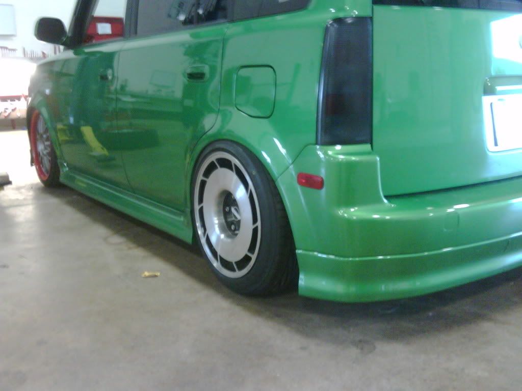

I will have enough space to tuck these wheels - 16x8.5 +38 even with the adapters
these are test fits and crappy pics
adapters are on order< should have updates soon!
