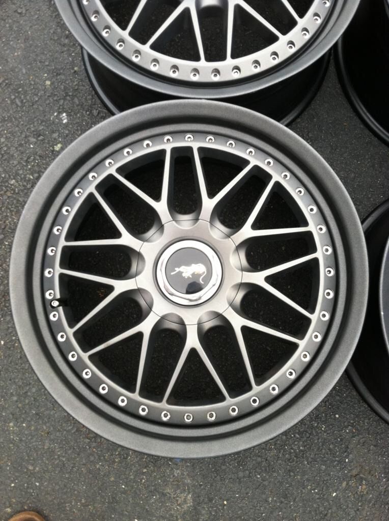

    Hey, I just picked up a set of what I believe are Desmond wise sports three piece mesh wheel in a staggered setup 18x8 and 18x9 both et47. I'm planning on taking the "front" two wheels and throwing new outer lips on them to make them wide enough for the rear, and then obviously making the current "rears" the fronts. I've tried to research what lips to use but I can't find any information on these wheels.
    Attached are some pictures so you can see exactly which ones they are

    Measure inner bore and bolt hole center to opposite bolt hole center.

      Okay and what about the cutout for the valve stem?
        What about it? You may have to run 2 stems.
        That looks like a standard 40 hole stepped lip. Get measurements to confirm.

          I'm only changing the lips on two of the wheels, so I need these to be the exact same (minus the upgrade in size of course) so running two valve stems isn't an option, but thanks for the help, if anything I'll measure and buy them and take them to a local shop and have them do the cutout for me
