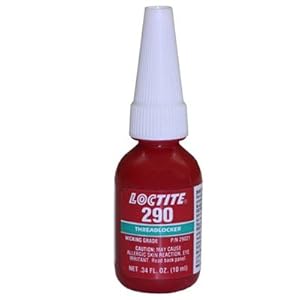

    Hi everyone. I am in the process of rebuilding a set of wheels and I had noticed a green threadlocker on the bolts and nuts before I disassembled them, so I thought I would do the same (I'm almost positive this is how they came from the factory).
    I used green 290 Loctite. It seeped in between the torqued bolt/nut assemblies just fine, leaving a small amount of excess on the top of the nut. The problem is the ring of excess resting on the top of the nut is still wet and has been wet for 4-5 days now.
    I cleaned the bolts and nuts with isopropyl alcohol before assembly and I shook the bottle of loctite before application. What am I doing wrong? What would you do?
    Pic of product:

    http://www.loctite.sg/sea/content_data/93808_290EN.pdf
    A quick google and the datasheet is up, should be fully cured in 24 to 72 hours depending on temperature,

      Loctite is an Anerobic product. It cures in the absence of air.
      Anaerobics, that include many of our threadlockers, pipe sealants, retaining compounds and flange sealants, are products that cure in the absence of air. These are products that are designed for metal-to-metal assemblies although they are sometimes used for other materials as well. The presence of metal (ions) accelerates the cure of these products. When you assemble parts with an anaerobic and you have excess squeeze out, outside the joint, this will not harden due to the anaerobic nature of the product. Simply wipe the excess away with a common solvent like acetone or isopropyl alcohol. Typically anaerobics fully cure in 24 hours at room temperature under normal ambient conditions when properly used.

          Checked the bolts/nuts the other day with a piece of paper and the green loctite is STILL WET between the threads. The bottle and package the loctite came in was really warm when I recieved it, so maybe the temperature from sitting in the sun in the mail truck did something to the loctite? I dunno.

            I told a local hardware store about this "problem" so they tested it with some of their own new green 290 loctite and a stainless steel nut and bolt. The loctite was applied to the threads of the bolt and the nut was put on finger tight, so that it could easily spin off.
            ***After about 5 hours the green loctite on the exposed threads and around the top of the nut was still wet, BUT due to the the anaerobic (absence of oxygen) nature of this loctite (and most other loctite thread lockers), the once loose nut was now tight on the bolt to a point that neither of us could twist it off. Only the loctite between the threads had cured.****
            Later, I tried this same "loose nut on bolt" experiment with a dirty nut and bolt as well as a clean nut and bolt using the excess green loctite that was left on top of the wheel nut and bolt assemblies. About 15 hours later the dirty nut remained on the bolt with light pressure, but eventually broke free; however the clean nut remained tight on the bolt with more pressure than was used for the dirty nut and bolt.
            The cool thing too is that the clean nut and bolt used in this experiment were previously used as thread cleaners (bult had a groove cut down the length of its threads and the nut was missing a piece of one of its sides. These missing sections were set opposite to each other during the experiment. This experiment supports that the green loctite 290 doesn't have to be around a "continuous thread", it just needs to be between a tight thread junction, so that it can push out any air, allowing an oxygen-free environment for it to cure.
