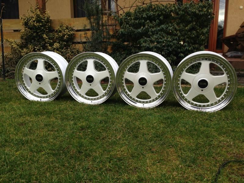

    Super hyped - just picked up a gorgeous set of OZ Futuras!
    18x8
    5x112
    ET35
    I've been researching and have an email into OZ. Stock wheels for the B7 Audi S4 use ball seats 14x1.5x27mm for 18x8 ET43. But it seems like most aftermarket wheels run conical.
    Do you know the correct lug bolts to run?
    2007 4.2L 6 speed quattro S4. Neuspeed catback. 20x8.5/20x9.5 BBS RSGT. PSS9. USC license plate. always my work in progress.
