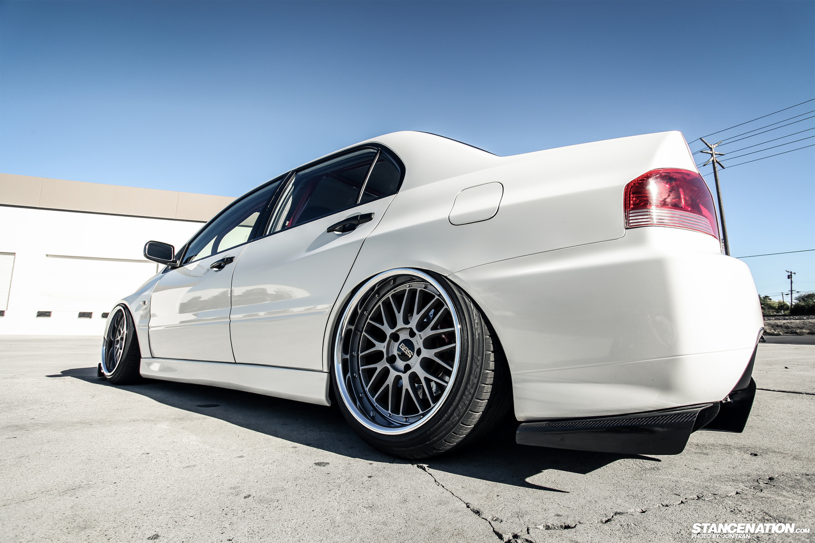

    Yep it's all doable.
    Otherwise you wouldn't be able to do the popular reverse mounting with them:
    There is also a guy that took 19 inch LMs and relipped/barreled them to 18 inchers with flat lips:
