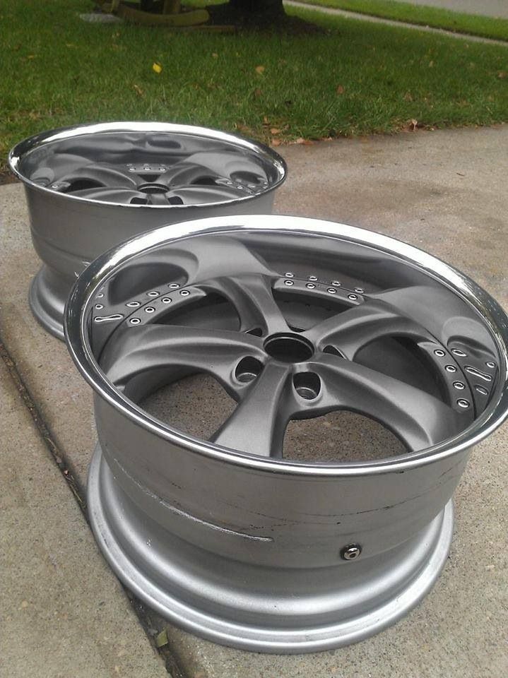

            I just got mine redone as well but now i need to replace a few of the nuts. Any idea of the thread pitch? I went to a local hardware store and a m8 nut doesnt screw onto the bolt a m7 nut did but 1. they didnt have a m7 flange nut and 2. the guy said that the bolt looks more like a fine pitch m8. Well with that i called work wheels direct and all they could tell me was that the bolt is a m7 and that they had no idea what the thread pitch was. Now im stuck with my wheels waiting to be re assembled so any help would be appreciated. MAHALOS!
            • #21

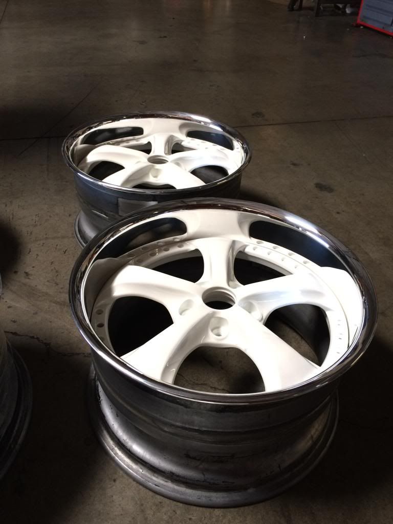

              haha after a quick call to wheel flip i found out they are m7x1.0 i ordered all brand new nuts from them.
              Its hard to tell from these pics but my wheels were pretty beat, spray painted faces and super dull lips
              and heres the after, lips are back to mirror and cant see in this pic but its a really sparkly white lol
