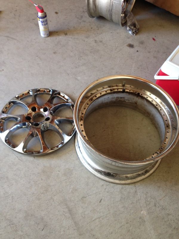

    Hey guys, so i picked a set of Riverside Altstadt 1 wheels It was advertised for $200 i got it down to $150 Not sure how rare these wheels are but im pretty stoked! The wheels are in good shape has some minor curb rash and one barrel has a dent and its chrome! im not a big fan of chrome so imma get it strip then get the center brushed clear finish and polished the lip or maybe powder coated it all black. Heres the specs 18x8.5 et36 Front, 18x9.5 et36 Rear

                We'll the lip & the barrel are welded together so I'm guessing it used to be 3 piece? Correct me if I'm wrong

                  Correct, but effectively now it is a two piece. This was probably welded from factory though. A ton of Japanese companies used to make 3pc wheels, then weld and put a seal around the weld. It is quite infuriating when you get a set with the intent to go wider but see that weld. If you want to go wider, you certainly can by having it machined off. Its technically the same process of people going wider on style 5s or other wheels with a solid barrel.
