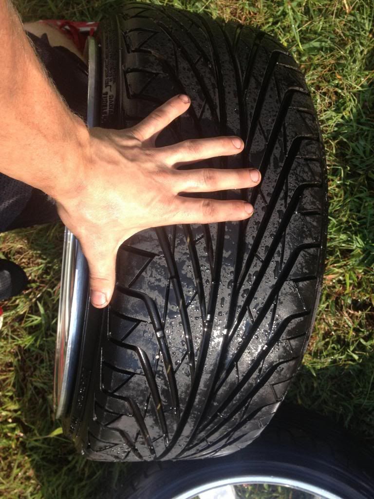

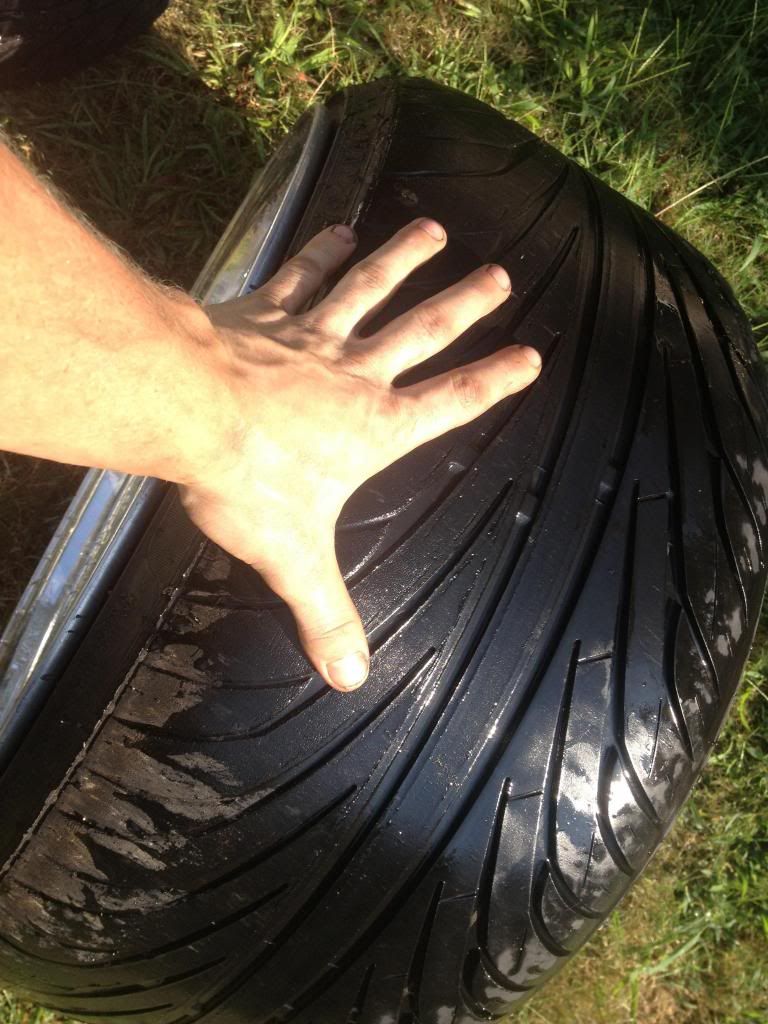

Originally posted by HighClass_iS View PostSold my car looking to sell my SSR's
Specs: 9.5/19 7" lips 11.5/19 7.5" lips -25 all around.
Wheels were flipped, so you can flip them for different specs.
No i dont know the original specs, Im sorry.
Not BBK friendly in the front, but rear is.
Originally came off a G35.
Comes with tires: 215/35 90% and 265/30 60%.
Comes with all Authentic SSR lips, valve stems, and hardware.
Polished inner lips.
