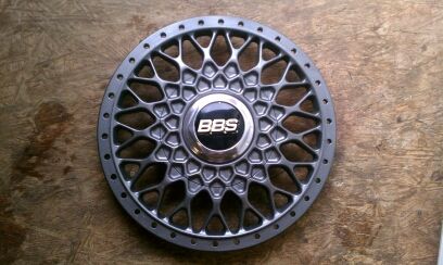

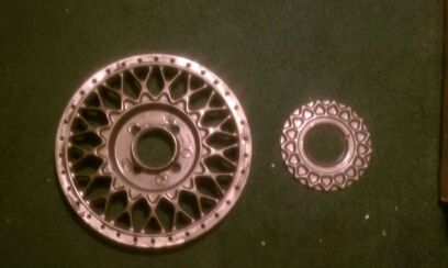

            These are some terrible pictures but hopefully it's enough to be able to tell. I have painted and clear coated them once already and the original paint was in great condition with hardly anything wrong with them.
            When I first painted them.
            How they look now.

              That's why I simply scuffed and repainted the 2nd set I did as the original silver was so good and didn't think it was worth stripping. This set I'm now doing I really don't want to just paint over the silver as I don't know what paint it is, or how many other layers are underneath, so dip it is this time.
