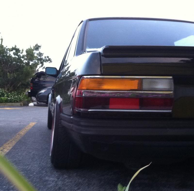

16x9 -10 all around or just out back? For the moment i will most likely be running cut springs since I haven't heard too many bad things about doing it, but am planning on building coilovers with e30 shocks and shortened strut housings.
Btw, nice boat!
