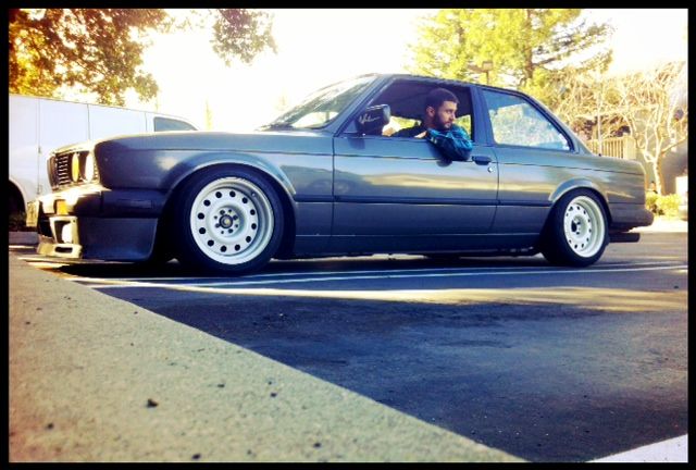

    ayeeeeeeee enjoy!
    IG @RobthaBavarian
      Thanks man Cars looking good Liking the chunky rubber look
        Stance Mindset, 15x8 Et25 I think, needed 3mm spacers up front to clear the calipers, the rear needs 15mm spacers for spring, tires are 205/50/15 and lowered on H&R race/Bilstein
