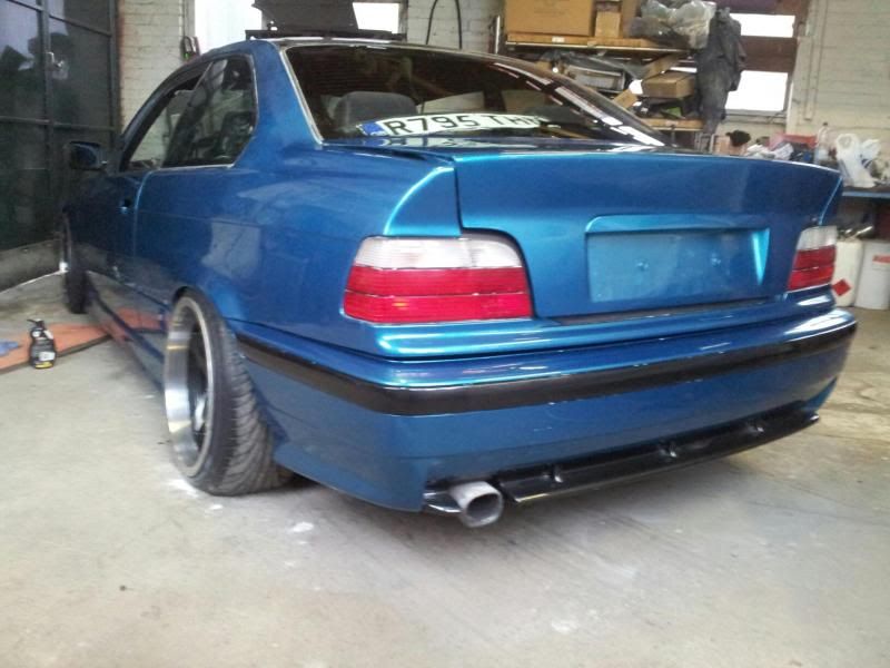

      my coupe on 17x10 ET 17 with 215/40:
      arches are rolled
        arches are rolled
        Yeah haha i probably would die. But yeah the fitment on that is pretty good, So 16x10 ET17 would be a very similar fit? Because if so, I'd for sure go with all specs above, different wheel size. Obviously not the same wheels something different.
