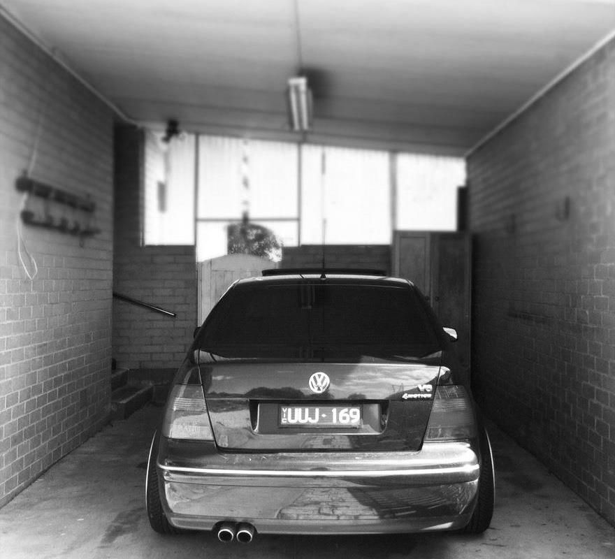

    Front: 18x8.5 +30 (and 5mm spacers) with 225/40/18
    Rear: 18x10 +25 (and 10mm spacers) with 235/40/18
    I've got KW V1s and they're lowered all the way in the rear (doesn't go too low) as I've removed the perch and adjusters, and the fronts can go lower but for daily purposes I'd rather not. The rear naturally has some negative camber when lowered.

    Current (rear):

            So hypothetically if I want the same poke on the rear and the tyre perfectly clears the guards currently, the 225/50/16 on a 9" wouldn't have as much stretch as a 235/40/18 on a 10" so it wouldn't clear?

              The rear will have 20mm less poke than the pictures above, and the front will have 8mm more poke.
