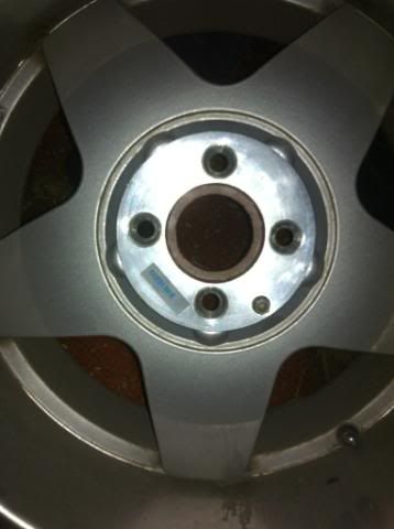

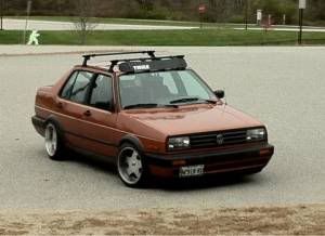

      these are pics of the actual wheels, they look like a pretty radical offset in the picture but they are on a jetta too, and could i use spacers with these wheels with the way they mount up?
      its fine if they dont poke out from the fenders, id just like them to sit level with the top of the fender

        those on a E28? . . . not a fan . .
        well . . you need to redrill em or get adaptors . . but to be honest, I wouldn't . . sell em and get something that fits . . there are many better looking wheels with 5x120 that fit to the lines of a E28 . .

          Those wheels could look alright but as stated above they are going to need some spacers and they are 4 lug so a redrill would be in order. the smallest adapters available (that I have seen) are 15mm... which would put you at an et of zero all around, which would be pretty aggressive. You could pull it off, but with a good amount of fender work.
            They're actually multi-lug with a factory 4 lug pattern bolted on. You remove that bolt in the second picture and the 4 lug pattern comes out, leaving the wheel looking like the third picture.
