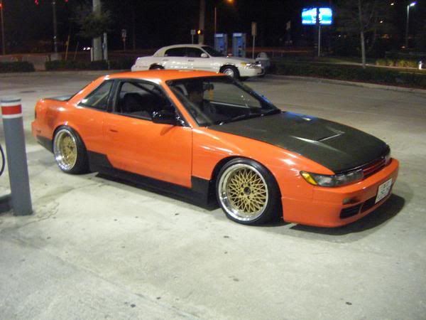

          Here is a picture of reverse meshies on an s13 that I fell in love with a few years back.
          17x8.5 -6 offset (front) 17x9 -13 offset (rear)
            The fronts will look exactly the same as the car pictured, and the rears will be sunken by (roughly) 15mm. But you can see that the rear fenders are pulled in that pic.
            I'm not a fan of that particular car, but on a coupe it should look epic.
            And yes, Zilvia has like 500 pages of fitment. There's bound to be a similar setup in there. lol
                  if that cars from florida, I almost bought it last year lol. LOVE that car

                      yeah its from florida, definitely a clean car with the aero on it. well i'll probably end up getting the custom wheels made with fitment closer to the wheels in the pic. The only thing though is that the company has only one color of gold and it doesn't look like the copper color gold that ssr uses. I have tried finding a paint code on the net but no luck, does anyone have an idea or a direction to point me towards to get the same gold color.
                        Those are Formula Mesh not Reverse Mesh on the S13.
                          lol, good job catching that. yeah i must have just accidentally typed that. i understand the difference as the formula mesh has the step lip. still waiting on hereing my quote from the shop on the wheels, since i don't like the gold color they offer, i will be doing black. should look good on my car since it is maroon. And I plan on painting the car white after its all said and done.
