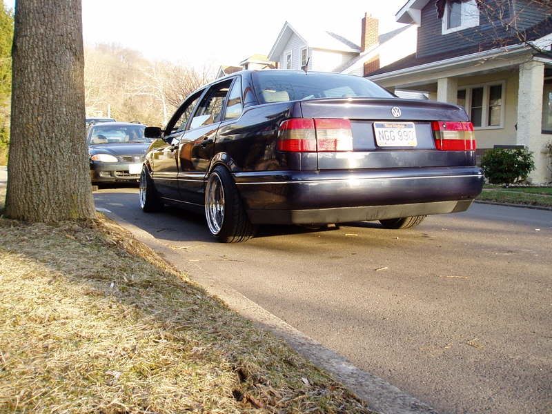

                        Found a picture of one with 16x10,5 in the rear. Looks good. Maybe a little too much poke.
                        So I think 17x10 should fit with some nice stretch, or I'll go for 17x8,5 all around with spacers in the rear..

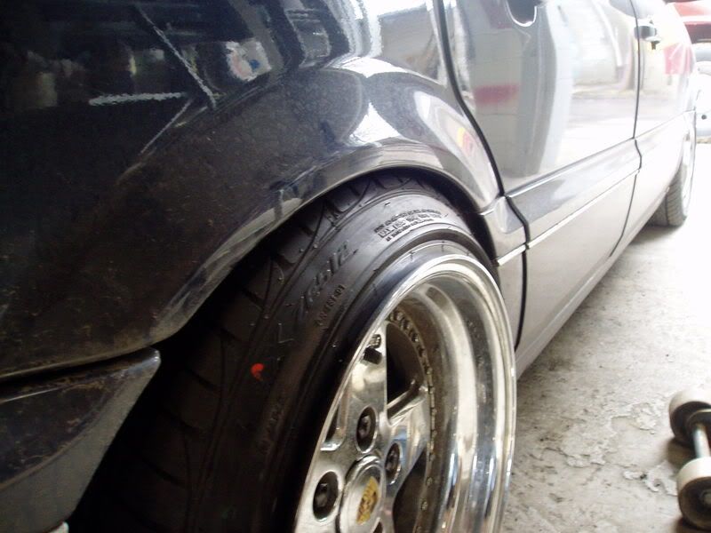

                          i had a 16x9 et 8 on the rear of my b4 wagon and it had very minimal poke if any at all
                          Insta Mintyhinrichs
                            Nice! I think I'll go for 17x10 in the rear then.
