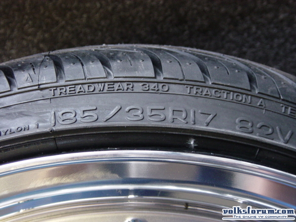

                If you want 185/35/17s, I can get them for you no problem. Shippings gonna be the deal breaker, though.
                They have a load rating of 82, so 475kg per tire.
                Pretty common size on 7x17, actually.

                    Nankang makes their NS-II in a 165/35/17, but it's not available in the US. They also make a 165/40/17 and 185/35/17. http://www.camskill.co.uk/products.p...7,_165/35_R_17
                      Right, there are several other sizes that can be had outside of the country. I was referring to the ones that are readily available to the US.
