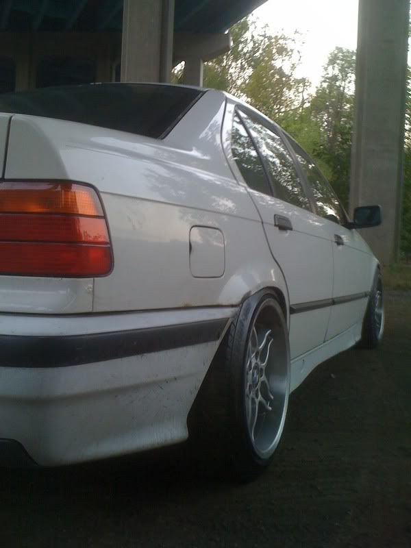

    For the rear, if I were to put a 17x9.5 wheel, what offset would I need to make the rims flush with the fender, after a little roll? I know if I go 17x9, it'd be ET20 but how about 17x9.5? &Would it fit without hitting anything once I slammed the car on coilovers? Cus if not then I'll just stick to the 9's. Any help is appreciated!
    9.5 et26 would poke the same as a 9 et20, but you would have 12mm less inner clearance. I don't know e36s so I don't know if you would run into any troubles with losing that clearance or not.
      Thanks, yeah I've been browsing a few forums trying to find out what offset I'd need if I got 17x9.5's. Cus I know if I do 17x9 it'd for sure be ET20. It's gonna be my DD and I don't want to have to do major work just to get the 9.5's to clear.

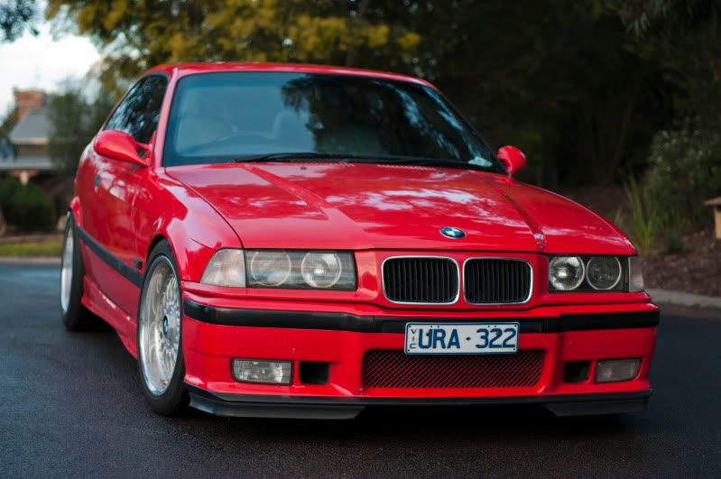

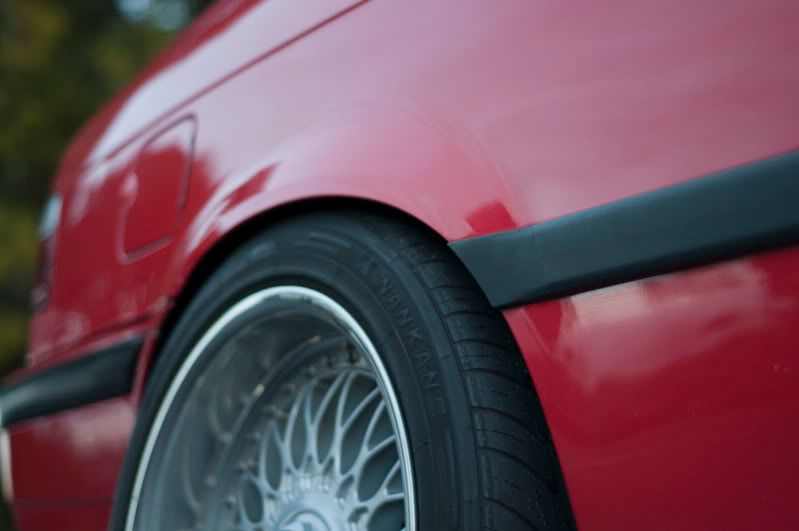

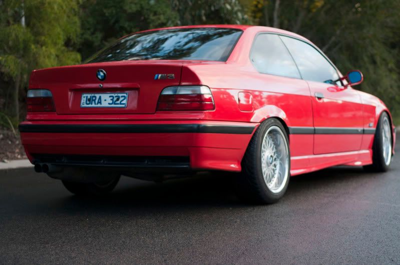

                  17x9.5 et.21
                  Car is an E36

                    17x9.5 et.21
                    Car is an E36
                    Good god that looks sick.
