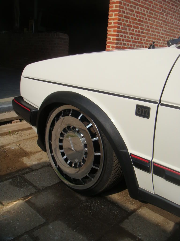

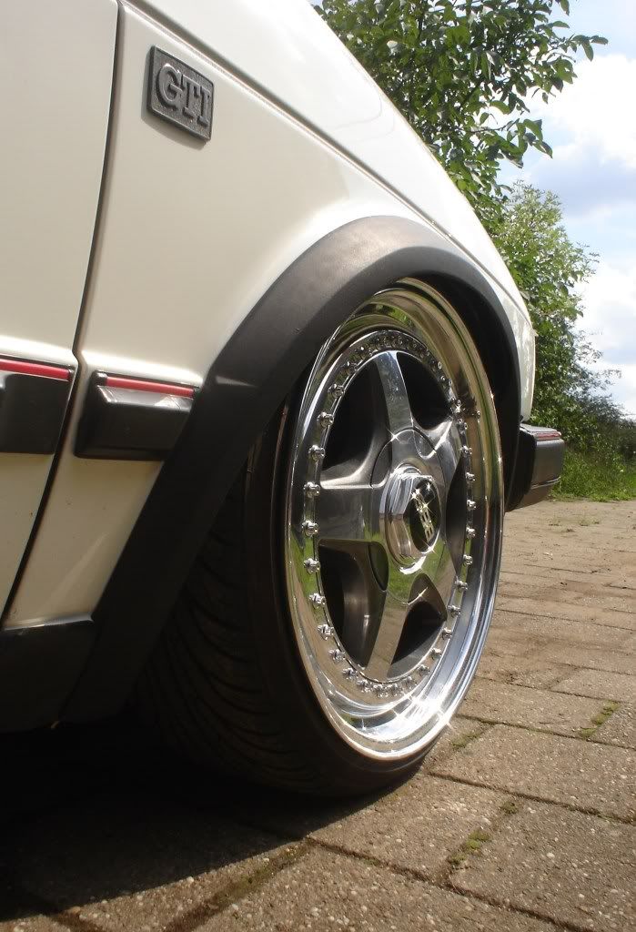

OZ Futura Step Up
Original Specs:
17 x 8.5 et56
17 x 9.0 et50
5x130
Built in 1993
New Specs:
18 x 9.5 et29 (All around)
5x112
Check out my build here if you're curious for more:
My Road To Futura: OZ Build/Timeline
