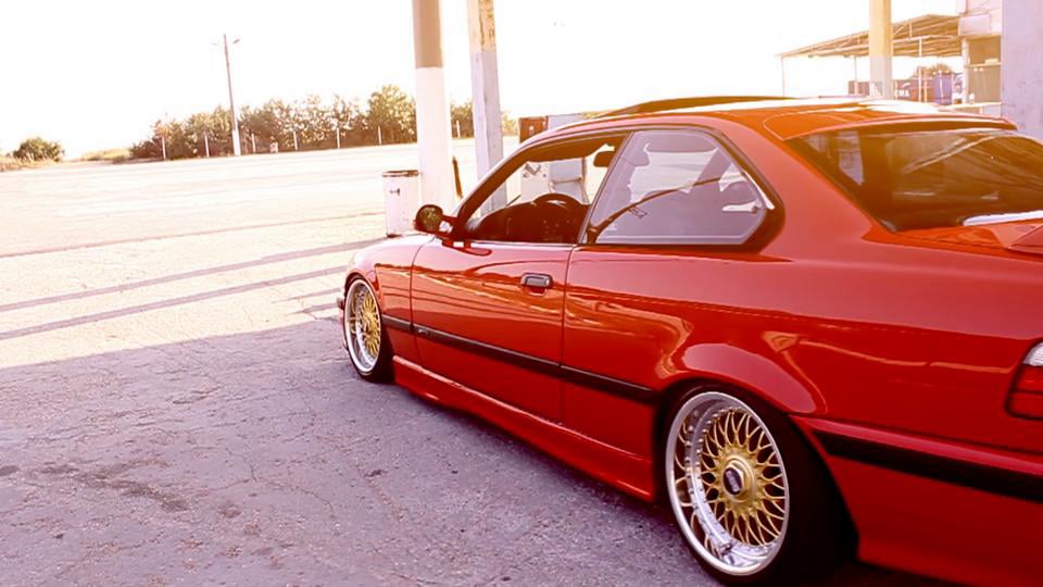

  • Video done and edited by Rollhard.net team of Cristian's E36 Stanceworks Romania .
