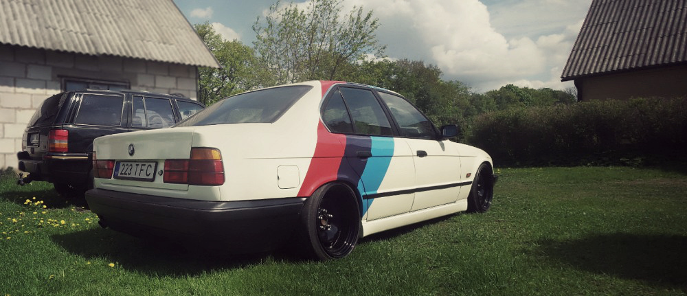

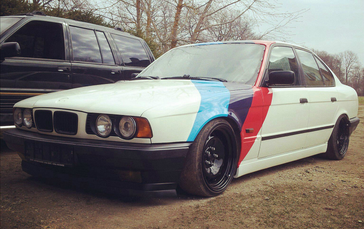

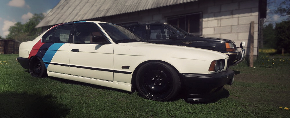

This car is at 17x10.5 the owner did never know the offsets, but he thought they were around -10. (Any old BFc's around, correct me if i'm wrong.) Rolled and pulled fenders, and they still rub.
Yours would poke around 27mm more than those (if he was correct on the offset assumption), with the adapters. I personally think it would look funny, since you would have to run such a skinny tire to make it fit.
