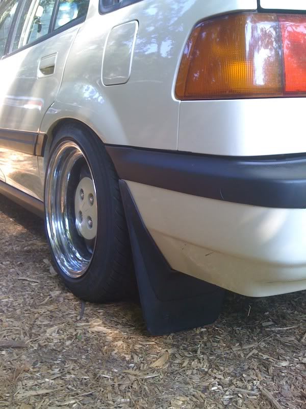

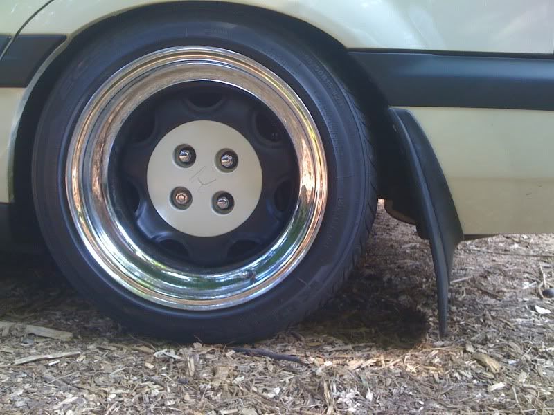

Just a few shots of my car. Any comments are welcome.
No quality pictures yet, but I just installed some rare OEM option rear mud flaps.
Wheels: OEM steelies/caps rebarreled from 13x5 to 15x8 0 offset. (needs more stretch/camber for the front though.)
Suspension: Skunk2 front shocks with Skunk2 sleeves/springs. New OEM rear shocks with Skunk2 sleeves and springs with custom extended top hats. I'm about a 1/4 inch from the top of my rear sleeves right now and about 2.5 inches from the top in the front. Rides like a Caddy, too. :p
