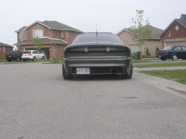

    1994 probe gt had it since 17(5 years) .. I am lowest in Canada, maybe north america, dont really know, and i am the first person to ever run a 9.5 wide rear wheel
    the unfortunate part is i couldnt do any form of research as to what fit.. and being in college and beyond broke, i got 1 chance to buy a set of wheels and either use them or im "****ed" .. got lucky i could make them work.
    wheels are 18x9.5 +25 rear and 18x8.5 +27 front .. 225/40/18 all the way around (front tire choice sucked, but i got a deal on the set, and like i said.. budget build ahha)
    2 degrees of camber in the rear.. once i get more camber bolts ill run 4 degrees.. probes seem to dump and still have 0 degrees!
    yonaka coils.. maxed out in the front, and about an inch more i can do in the rear, except the inner lip of my wheel is inside the adjustment rings,cant go any lower without a bigger spacer
    My coilover takes the paint off my rim.. im that close .. anyways im sure all you guys more then understand

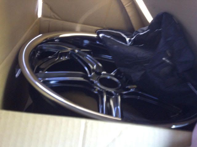

    Got 18x9.5s' for the front as well now.
    225/40/18 stretched on

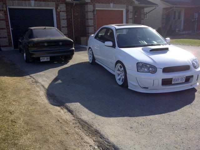

    probe and roomates sti
