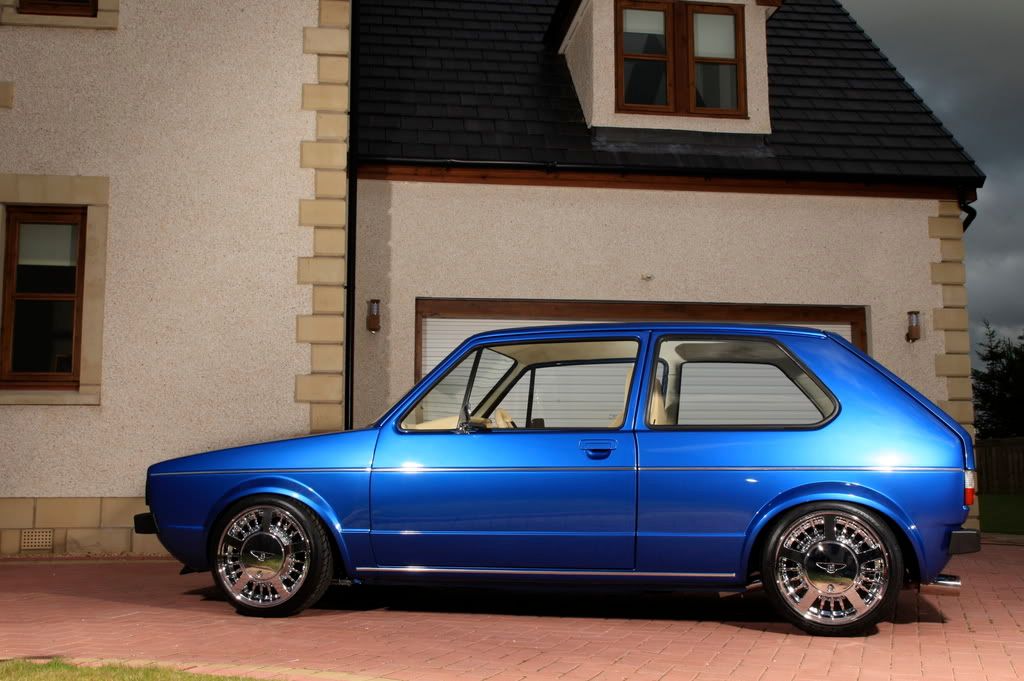

Been asked to post some built pics of my MK1 project so here goes little over 3 year ago i bought this mk1 it was an ex uk show car.
The car was originally restored and rammed with a big ass sound system back in 99/2000 (All Before I bought it) sadly in later years its went a bit worse for wear. So the plan was to fully restore the body with a few mods and change the colour, replace the Engine, running gear, interior and add a few trick extras to make it slightly different to the other MK1's around. It turned into a much bigger project than I first thought to be honest….
Then decided to restore it.... then things sort off got carried away a little bit

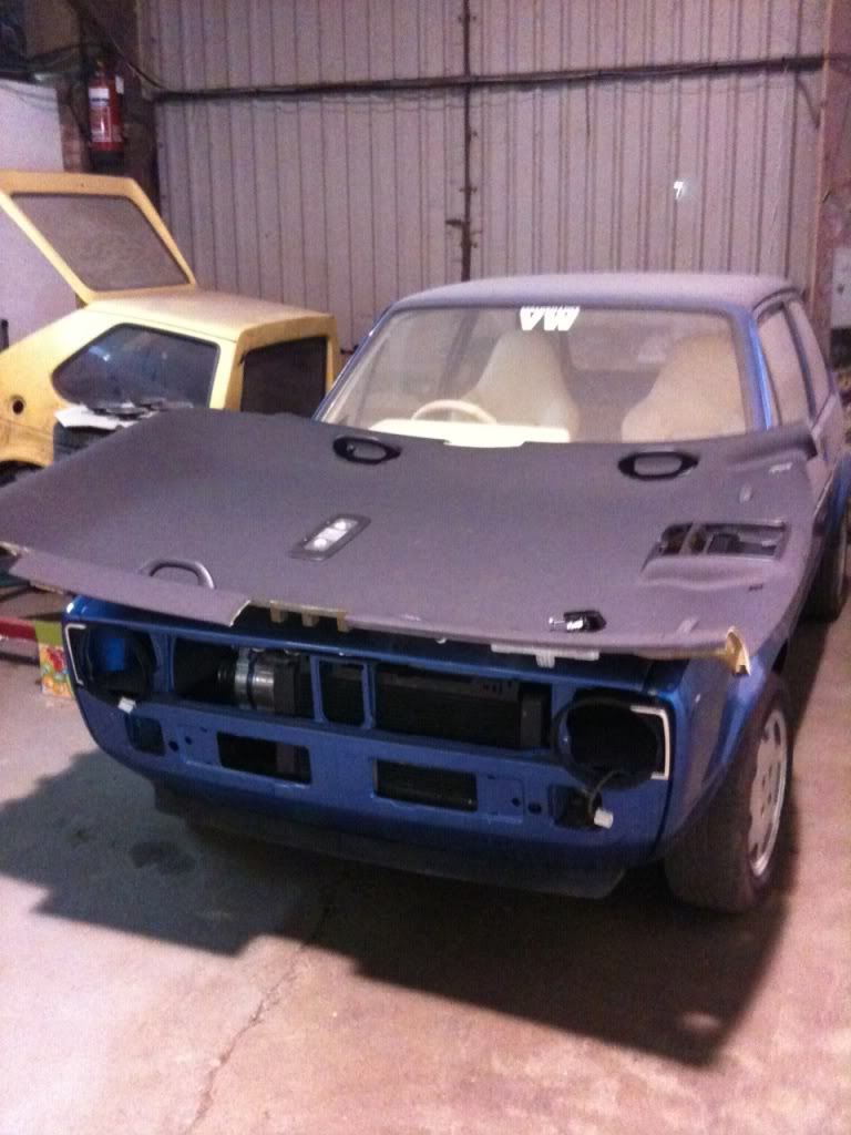

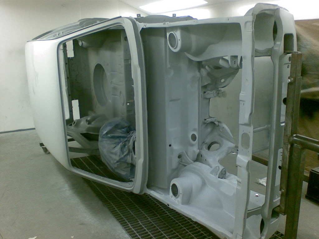

The car prep'd and away to the paint shop

The front and rear valance was removed, arches dressed back and corrosion cut out. The Doors wings, bonnet and tailgate preped. After many many hours I also managed to remove the Sound proofing from the WHOLE interior, which was a bloody nightmare.

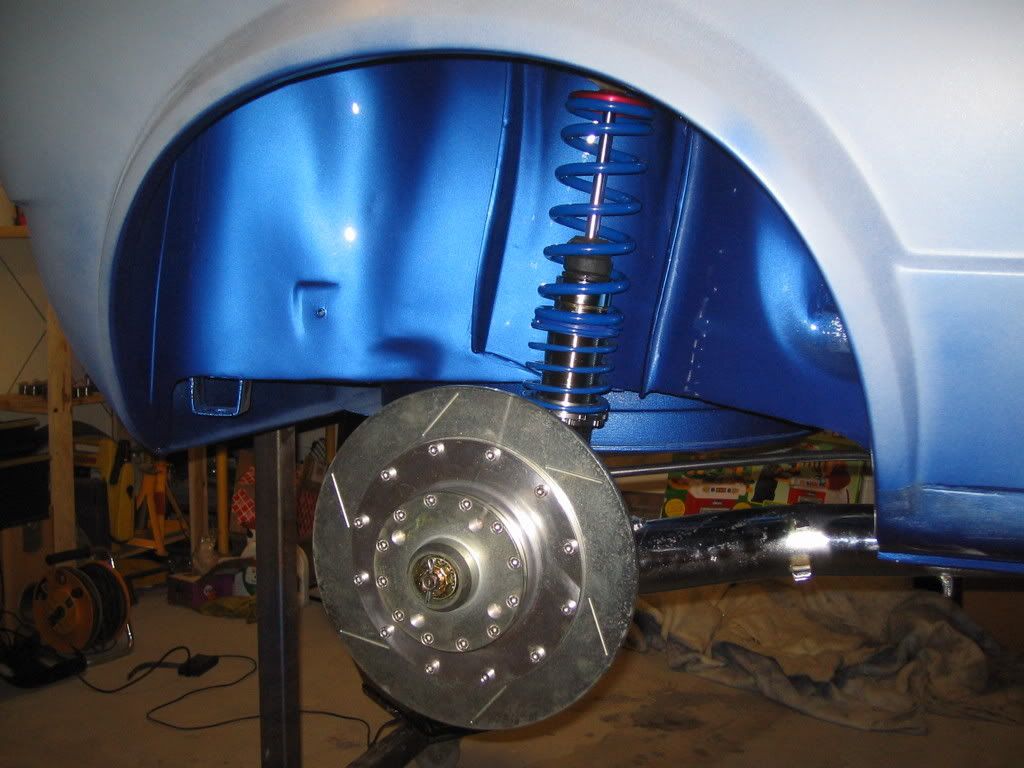

Continued the work on the arches, it was a long slog but it was worth it in the end
Front and rear panels welded up in place, the rear quarter repaired along with the inner arches.

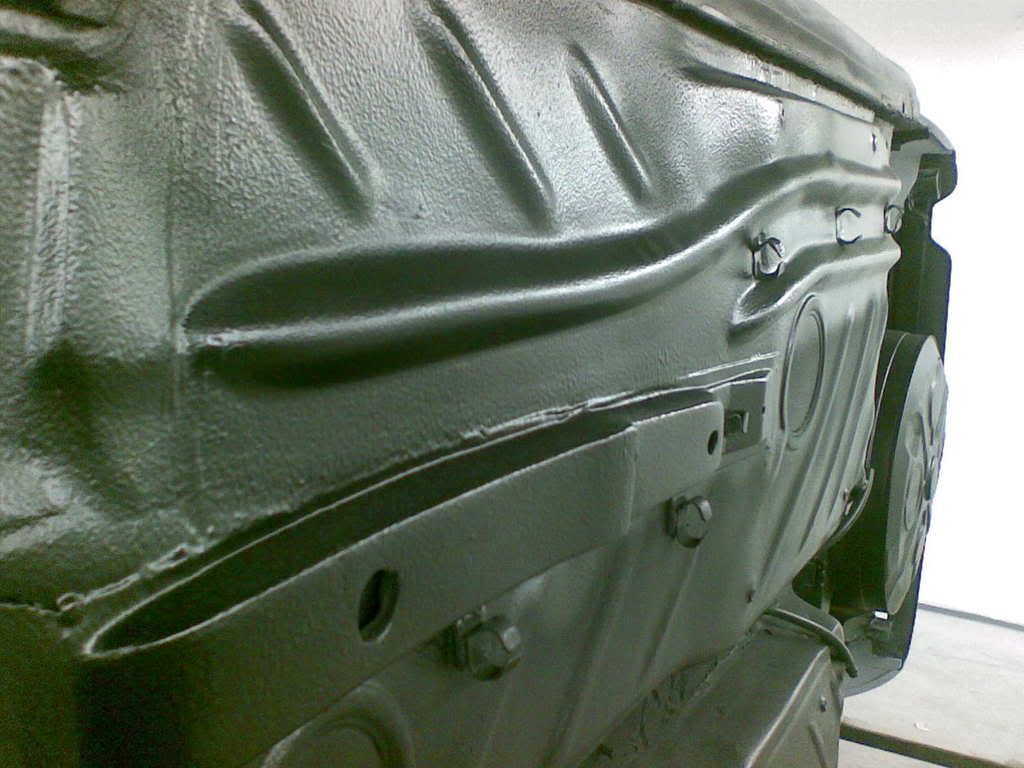

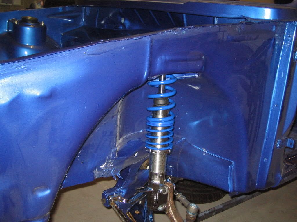

I’ve had seen a few people remove the underseal and paint the inner arch but most seem to stone chip then paint, however I wanted to go for as good a finish on the inner arch as the rest of the car. So there was no choice but to fill and smooth off, took ages and trying to recreate the lines to retain the original look was a nightmare.
The chassis legs were also flushed off, templates took ages to make up but look the business when welded in.

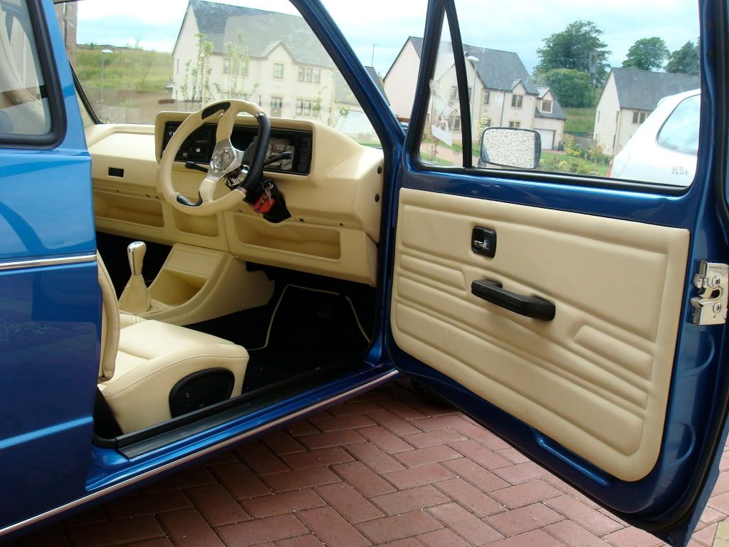

Had some lengthy work to do in order to get the new seats in, passenger side was slightly easier than that of the driver’s side. On both sides the runners were removed along with the cross box section, on the drivers side wee needed to take an inch out of the tunnel in order to fit the seat in.
Also removed the box section for the rear seats from the top of the rear arch, as it’s no longer required, plus it cleaned up the inside

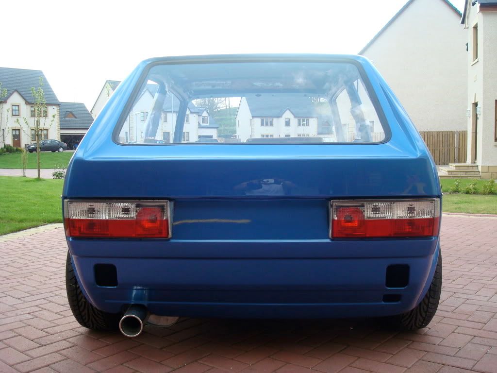

The rear pannel was also all welded up and filled ready for primer

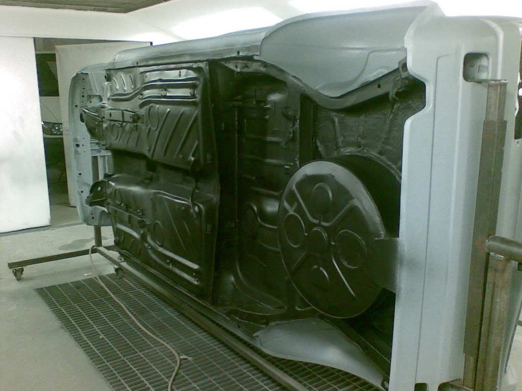

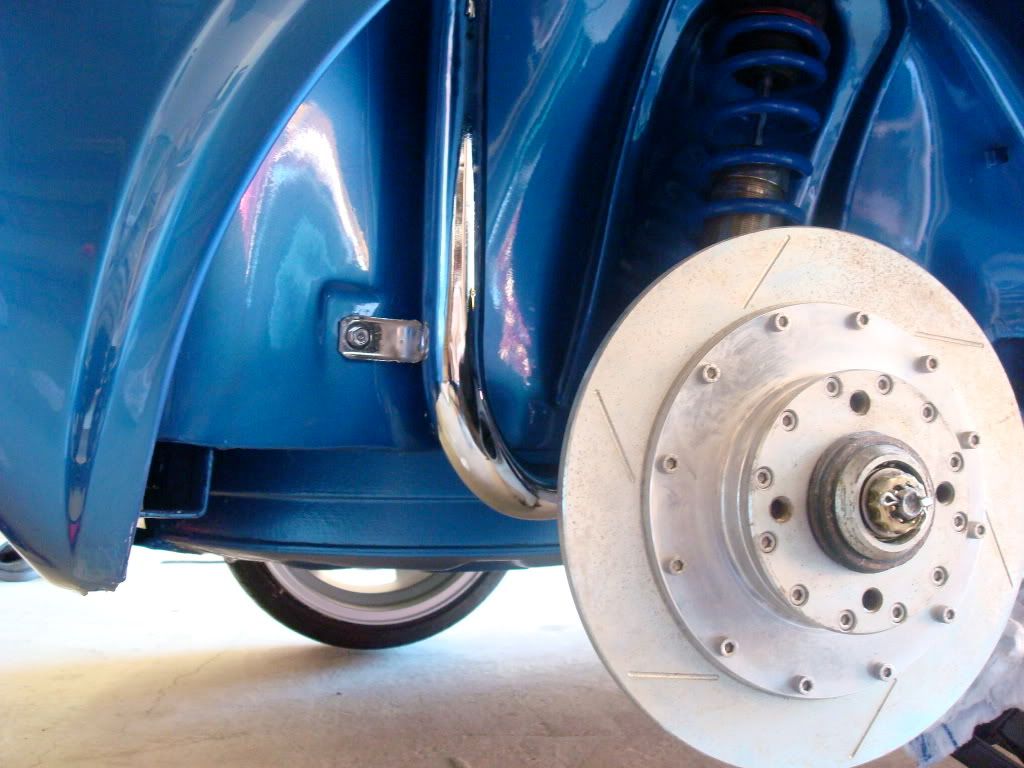

The underside was all been stripped back filled and smoothed ect, the pics aint the best, the filler is the wrong colour for my camera

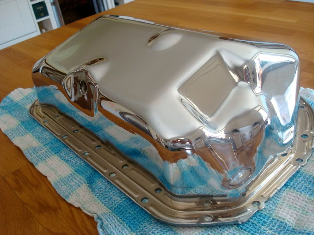

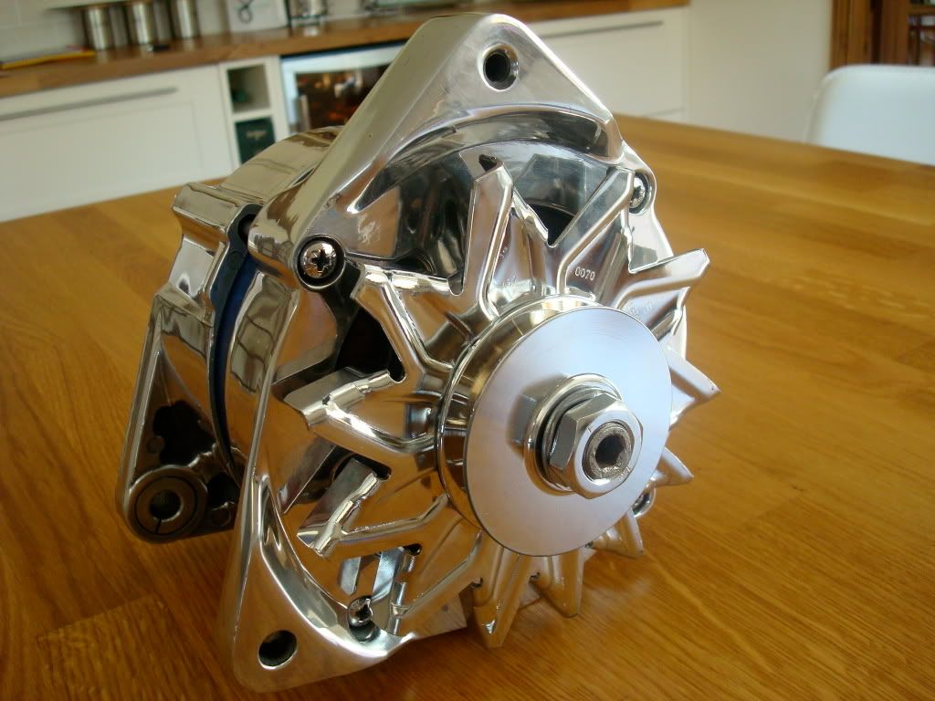

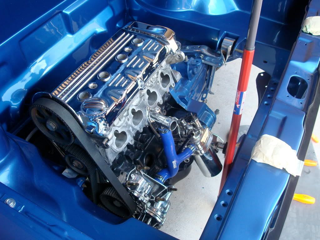

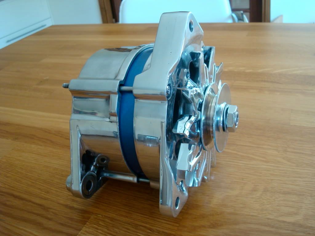

First batch Chrome
First batch Chrome
