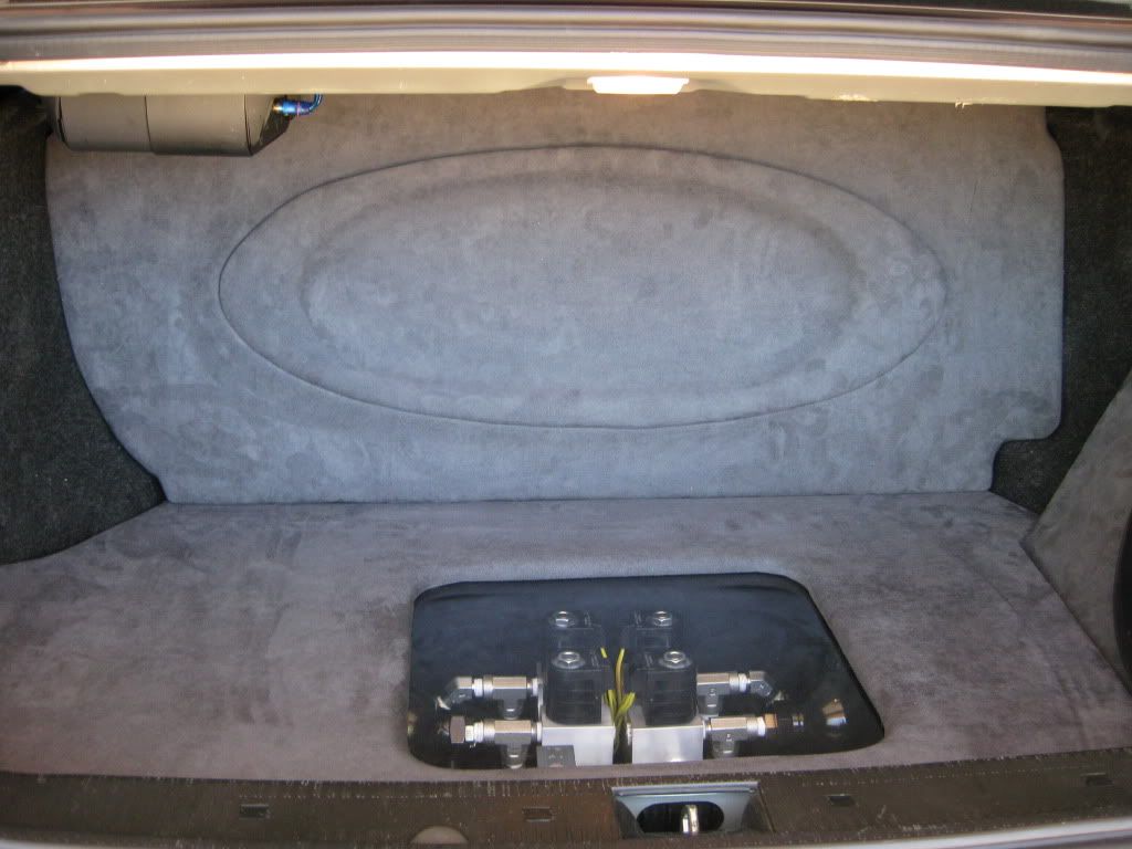

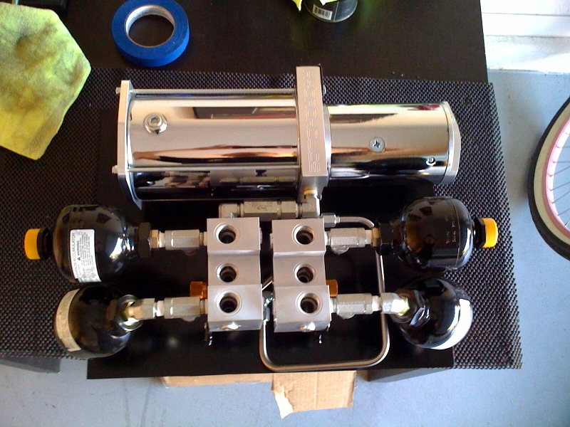

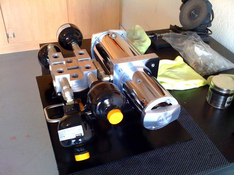

My New Hydraulic Build has Begun
Well, air cylinders don't get low, which is what I want. I'm about tuck...Originally posted by NegativeCamber View Postnice! in for more updates. although, it can go both ways. i wouldn't say those are advantages over pneumatic through...
if bag expansion is an issue, you can use air cylinders. for power, just toss in a high compression tank with helium or nitrous, instead of just the air tanks alone. some use the engine driven ac compressor for very fast refills. i agree with you on the air lines. in regards to pneumatics bottoming out, well thats largely the result of the design of the system. better shocks, length of the assembly, and pressure at the lowest hight would determine the ride.
As for everything else, it's personal preference I guess.
