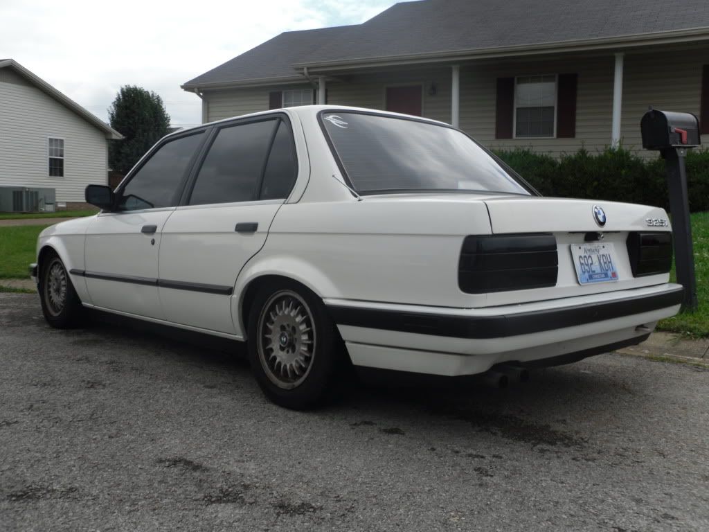

    Well my GC's came in. Cut the tubes 2.5" and cute the tube spacer 1" welded them back together, welded the perchs n the M3 sway bar tabs on the tubes and paint them Rustoleum Sunrise Red. Springs still have yet to fully settle, still have about 1/4 of the perch out back and half of the perch out front...soon as my skid plate gets here im gonna toss on some more low and 2 deg. -camber.

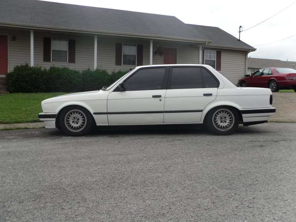

    My driveway has a small slant in it and this is as far as i can get up it without draggin the exhaust sooo this is where i park.....lol
    See theres still some light left under the car, atleast until i get the skidplate.
    Fuckin sweet man. That is pretty damn low. Way to take care of the suspension before getting wheels too, haha.
