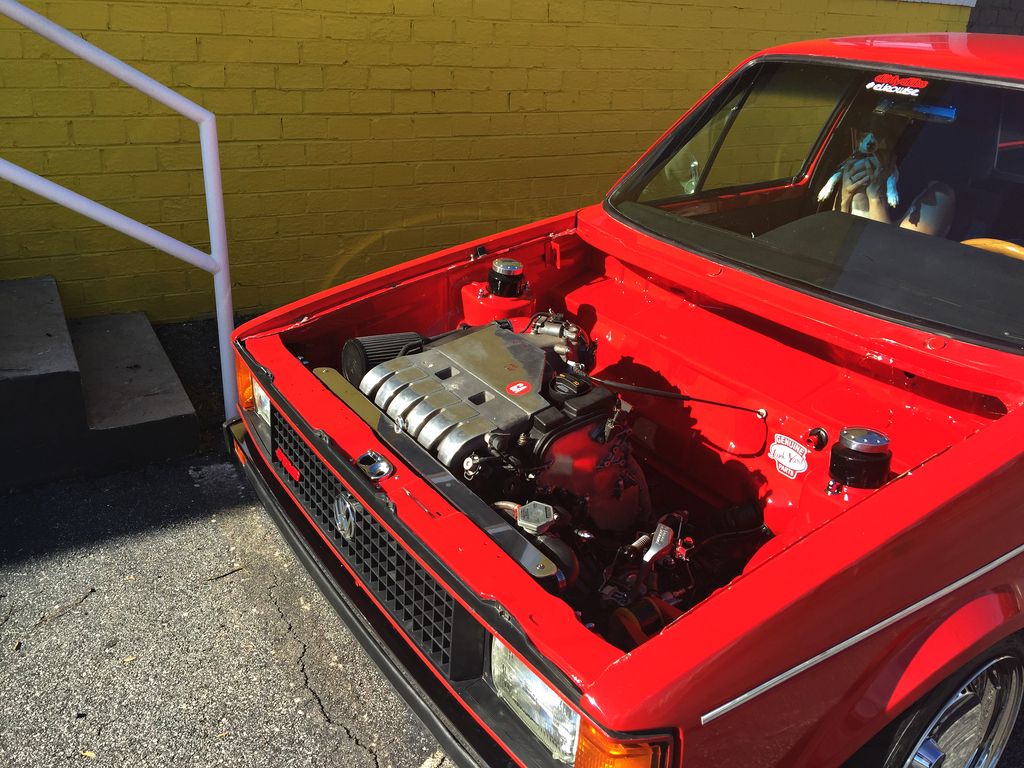

    I've been a long time lurker, I figured I might post a pic or two.
    Elvir
    Simple_Build
    Ah damn. That is amazing! Nicely done.
      Nice!
        Doesn't get any better than that.
          thanks all,

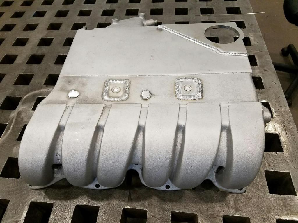

          The biggest eye sore right now is the intake manifold. Nothing has been done to it, but now, I am starting custom one, so hopefully it turns out like I plan.
          Simple_Build
            Simplicity works! Loving that engine bay!
              Man, you have a really nice caddy, that bay is insanely clean, any work done to the VR?

                Yea its had some work. The head was ported/polished/hot tanked with titanium springs and valves. It has MK4 head gasket, power intake gasket, C2 chip, Intake, Exhaust, 262 cam, Clone 2.9 Intake manifold (still in works) MSD ignition.
                And this is the 2.9 clone manifold that is in process of being completed. So it should made the bay look a bit more appealing than what's in it now.

                            Well, after several months, the bay finally is coming to a closure for what I wanted to do to it. The next thing to tackle is all new break lines as that rubber hose is just plain ugly.

                              manifold is sweet
