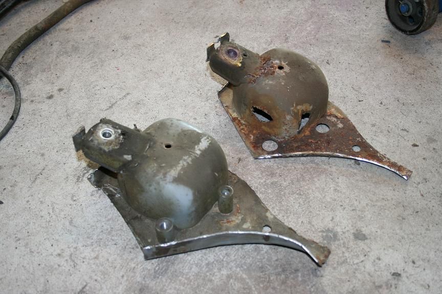

                    Ok, a lot of rust around the car. What can i do? There is no way back..There is only one solution... to go to the garage and make things better..

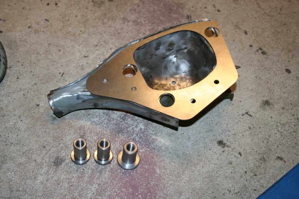

                    replacement rear trailing arm mounts from yankyard find E36 is the easiest way.
                    reinforcement plates for E36 axle mounts.
