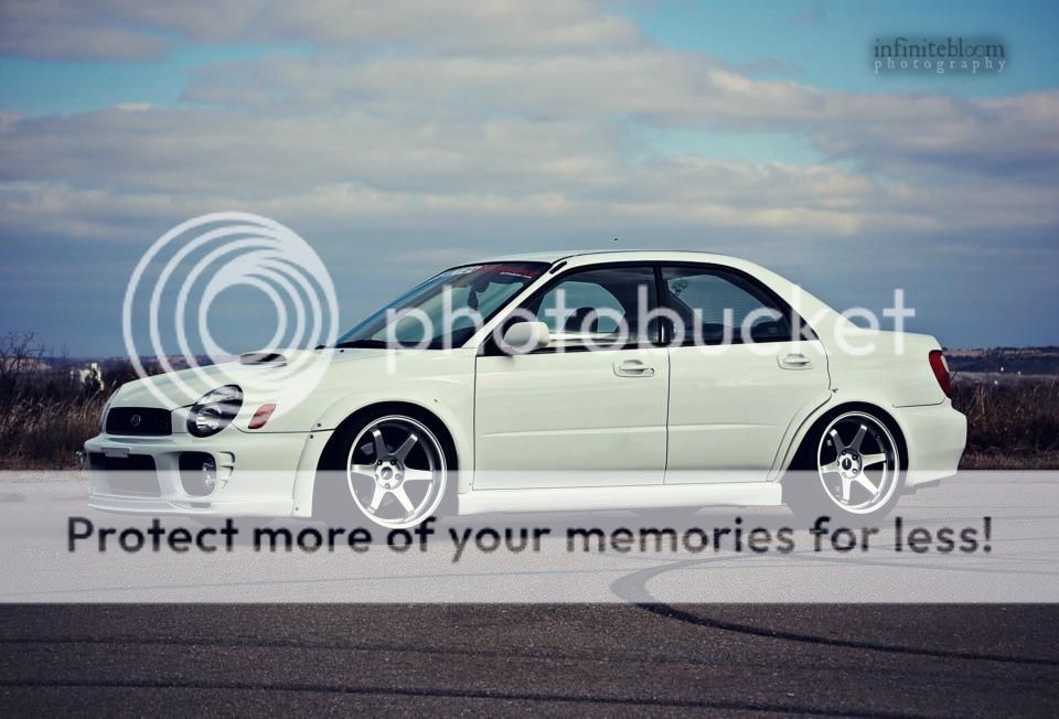

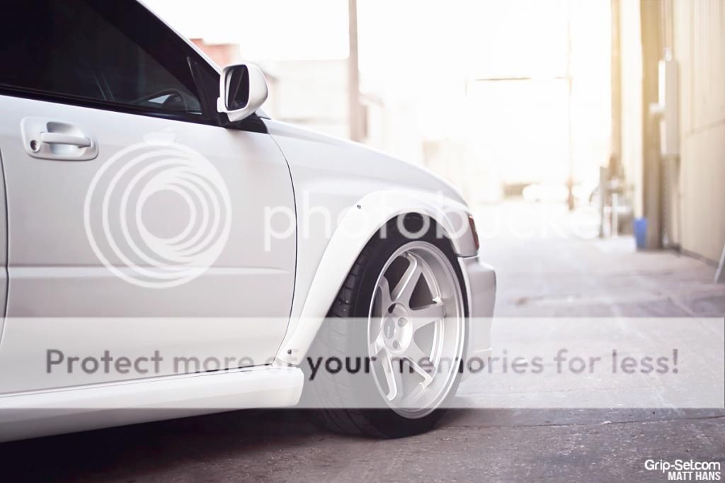

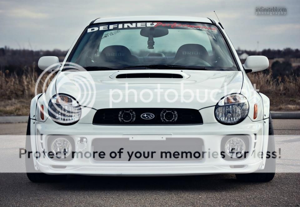

These are the Karlton Flares, they were molded perfectly so all i had to do was cut the fenders, drill and bolt them on. The wheels were 18x10.5 +20 on 25mm spacers with 265/35/18 Tires.Originally posted by Edirty6 View PostSo awesome, the meaty look works with the flares.
What flares are they? Did you have to work them so they fit? Wheel/tire specs please...thanksLast edited by Duffy; 03-17-2015, 06:10 AM.
