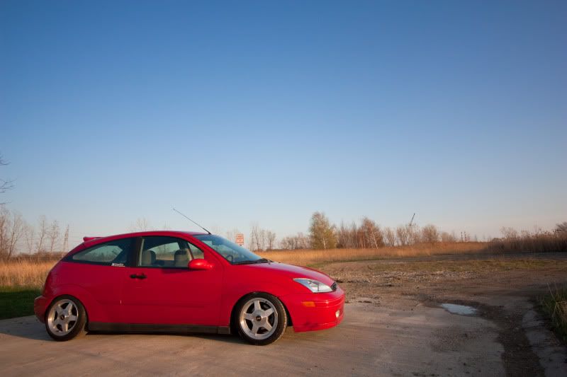

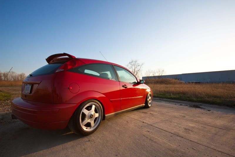

    Finally got my car close to where I want it stance-wise. Still need to dial it in, but I cant wait to post anymore. Still a lot more to do to the car overall, but its just my daily driver.
    Those are from the day I got the wheels on. Rolled fenders and dropped a little more. Still need to go lower and spacers in the rear.
    ^^lol wide angle lens
    Still work to be done, but I'm loving it right now. Wheels are 16x8.5 up front and 16x9 in the rear. Running 205/50's all around cuz I got them for a steal.
    C&C welcome.

                      Thanks everyone. No new updates, other than a few little touches here and there, but few of us went out and my friend's snapped some pics. Heres a couple that one of them took.
                      Sorry bout largeness of pics, next size down on flickr was just too small.
                        Just realized I never posted stuff about details of set up. Just in case someone wants to know.
                        Suspension is H&R Sport Cup Coilovers, front has room to go down, rear has one coil cut out. Currently running KYB AGX shocks in the rear due to blowing out one of the H&R's. Gonna have the H&R's rebuilt for more low.
                        Wheels are Simmons Type 670. Were winter wheels for an old Fox Stang. 16x7 et19. I had two widened to 8.5 et38 and two to 9 et44. Then had them refinished to like new condition.
                        Tires are Goodyear Eagle F1's, 205/50. Not my first choice in size, but I got these tires brand new for a hell of a package deal with the wheels.
