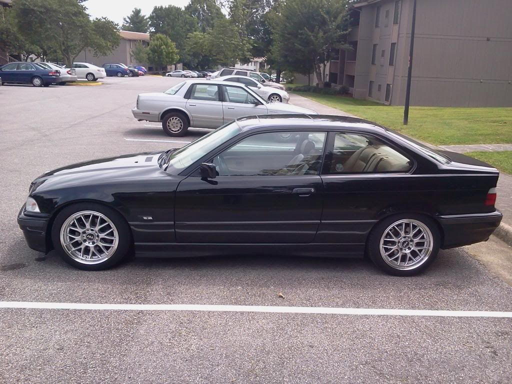

    First pic I took of the car after I picked it up from North Carolina for 3.5k.
    First thing I did was replace all the amber lights with clears as well as acquiring some depo headlights. I then got the large dent fixed on the passenger door that can be seen in the first picture. After realizing that all four stock wheels were bent, I quickly purchased a set of ASA 17x8 wheels on a 225 tire. There cheap I know.

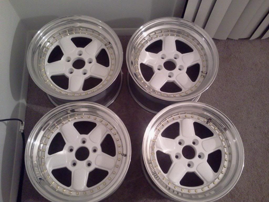

    I just purchased a set of AC Schnizter type 1 wheels ....17x9 et6 in the front and 17x10 et19 in the rear. I wanted a set of Hartge Splits but not willing to buy out of the country.
    A set of AC Schnitzer center caps/stem caps are on the way

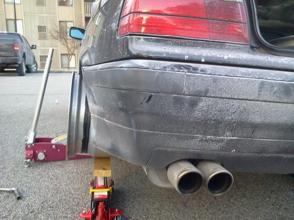

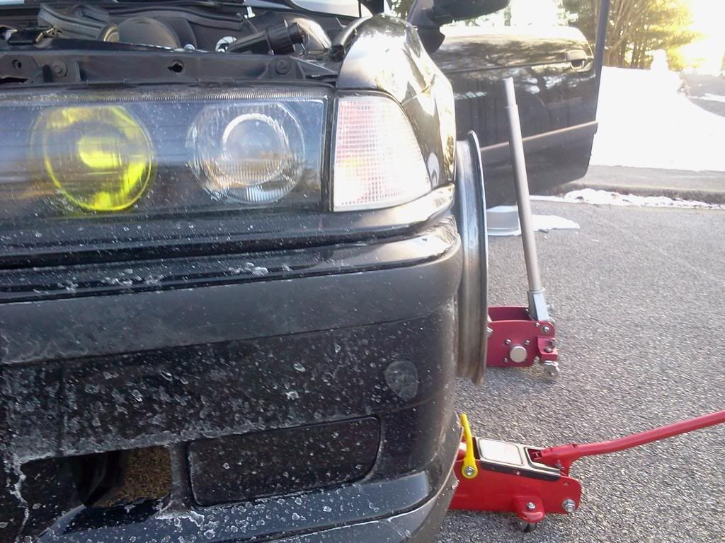

    As you can see I'll def need a roll/pull in the front and rear. With the wheels installed, I'm only running -0.5 in the front and -2.0 of camber in the rear. I plan on getting a shim kit for the front as well as camber arms for the rear if needed. The ISC coilovers don't provide a large amount of negative camber.
    I apologize for the low quality pics but my Nikon just broke. At this point, I am trying to figure out which tires to buy. I am thinking a 205/40 for the front and a 215/40 for the rear. I'm open to ideas or suggestions on my current setup. I will post again with updates when its all finished.

              Those tire sizes should be perfect for a nice stretch. Everything fitted right, it'll look dope !

                Thanks man. I'm still on the look out for some mint hartge splits so I may end up selling these in the near future.

                          Excited to see how the wheels look on the car. White and gold wheels always looks good though.
