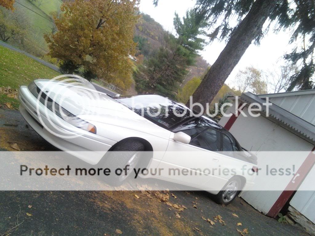

The day I drove it home: October 26th, 2009:
The car was sharp and it drove fantastic. It was a BLAST in the snow, even with bald tires it got me everywhere.
Little did I know the directional wheels were on backwards...
