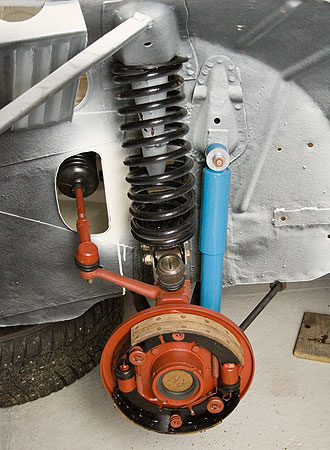

            any pix of your suspension?
            Is this how the front look?
            These should be around the same spring id
            you should take one and measure the inner & outter diameter and length of the spring. Also, the shocks max compression height then buy shorter coil springs with adjustable sleeves.
              Nope, the 900 has McPherson struts up front.
