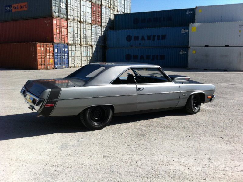

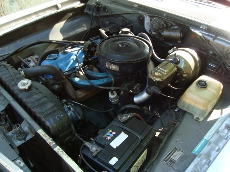

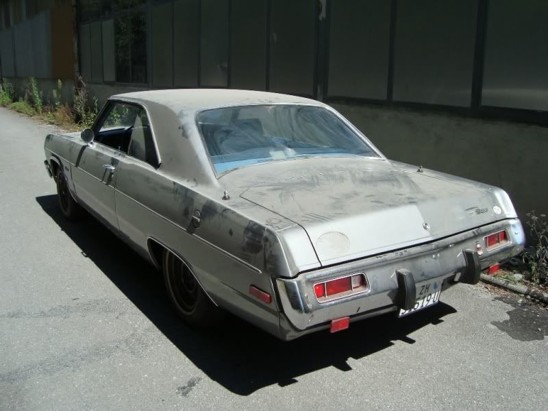

    Here my 2nd car... it's a 1973 Plymouth Scamp. The car started as a Slantsix (3.7L) with incredibles 95HP...
    This was the car when i bought it...

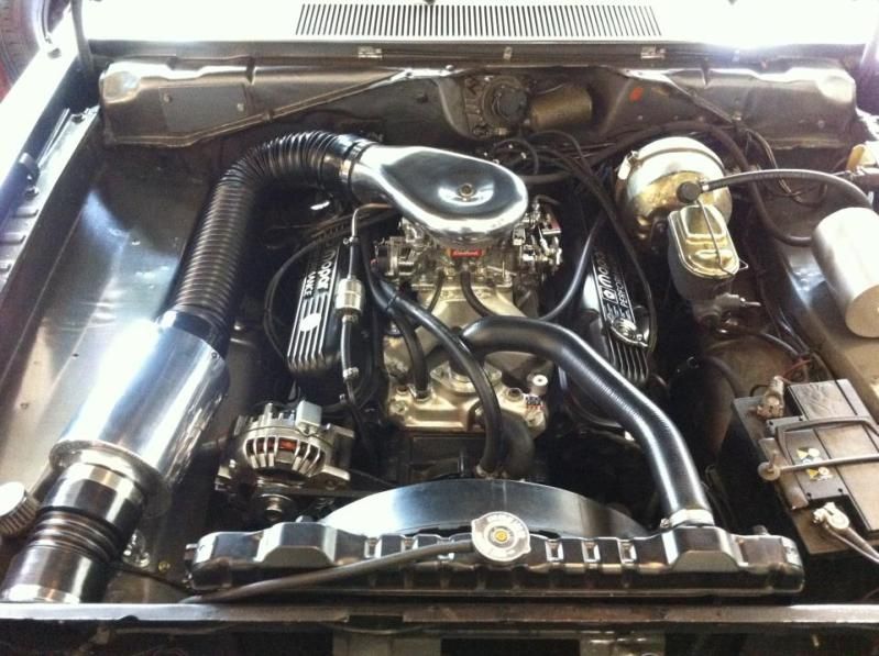

    I fixed a few things on the car and converted it to a 340cui V8...here a few mods:
    - 340cui H.P. Engine (1971), new pistons (10,5:1), modded heads, Comp-Cams cam, Edelbrock Air Gap intake, modded 600cfm Edelbrock carb, Spectre air-intake-system, TTI-Headers polished and ceramic coated, TTI exhaust-system 2.5" with H-Pipe and Flowmaster 40's, FBO Ignition... (approx. 400HP)
    - 727 Torque-Flite automatic trans, reinforced, billet-servo, shift-kit, 10" Converter with 2400 rpm stall...
    - lowered (3" front / 2" rear)
    - O.E. steelies (14x5.5 front / 15x8 rear - 205/70-14 / 245/60-15)
    - matte hood with 6-pack scoop
    - bumble-bee stripe rear
    - custom front spoiler
    - new carpet, new bucket seats and seat covers...
    - and much more...
    Here a few actually pics:
