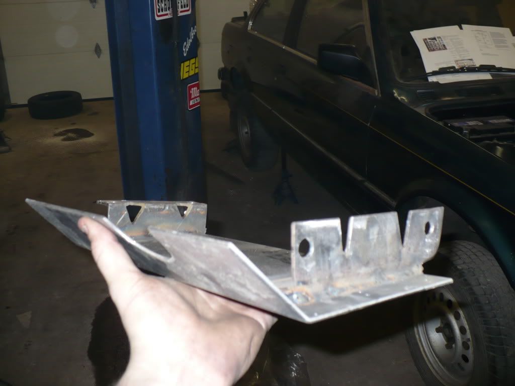

    thanks dude, how much time do you have? I started with ground control coilovers, went all the way down with them, was no where near as low as id hoped for, so i initially had a friend machine up new front perches for the front to lower it 1.5" more past what the coilovers could deal with. Which that literally made the strut mount sit bottomed out on the strut, so I designed and had machined a completely one off set of strut tubes, used koni yellow inserts that were shortened, the strut tubes also lowered it another quarter inch or so. I had to hammer over the pinch inside the wheel well because the stock size tire sat on it when i let the car off the hoist. The rear GC sleeve is also machined down farther so I got an extra inch out of the back. I have an idea for a new rear strut mount as well that should get the rear down some more and bring back some shock travel as well....
    Originally posted by dare23 View Post
    Low j-body!! Pretty brave on Toronto's roads
    haha, thanks... I took the first pan out of it pulling into my shop this past wednesday, the day before I left for H20i. So I built a skid plate:
    Car took a beating this weekend, its nice to be able to smash nearly anything on the road and not worry about grenading another pan.

                can i get a skid plate? lol

                  I was actually thinking about making a few, im going to redesign them to come back a little farther, mine leaves about an inch and a half of the pan exposed behind the lip of the plate, it will never ever hit anything, but I wanna make sure that it wont. Plus I need to make the rear bend up a wee bit, cause mine gets caught in my driveway backing out

                      Haha, I dunno man, havent looked at it yet... still lots of oil in it anyways so its doing its job!
