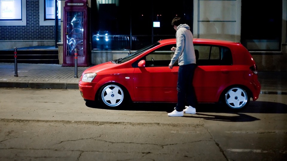

      nice work, but i think rear tyres is so big.
      So, how about rear bumper mount? My tyres are rubbing when the road is waved, but my offset is not so big as yours =( i think the problem is the bumper mount

        what is your wheel specs?
        well, i rolled and pulled my rear fender to fit those wheels

                  175/55 15x7j 28 off front, and 20 off rear. Eibach springs -2.5 coils front, -2 rear
                  I'm roll my fenders too, but I'm use little effort ))
                  Now I know why my tyres is rubbing. I roll up my rear fender on top and no on rear door side. I need the baseball bat =)
                  You can view more photo on my profile in russian cars community:
                  Про машину: 2005, 85 л. с., двигатель бензиновый, механическая коробка передач. Авто покупалось как жоповозка и еще год назад я говорил, что она и так низкая, занижать не буду )) Прошло время, идеалы и желания поменялись. Сейчас работаю над экстерьером авто. Тяну стретч, крашу д…
                  maybe I'll post theirs in this forum

                      yup, you must roll on rear door side, coz my tyres sometimes rubbing on that area
