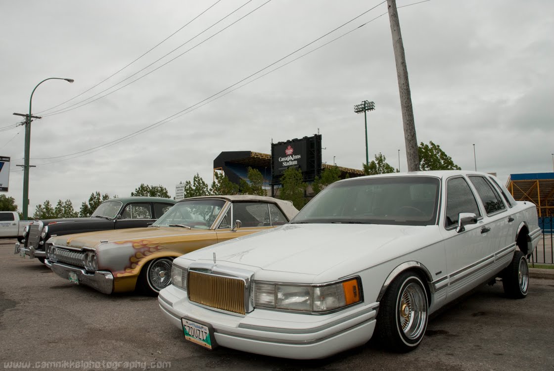

Here's how i rolled since Spring 09, 08 it was the same just Without the Gold grill

3wheelin at a local show.
i need to do rear link bars and also get longer brake lines for the rear. NEw frame too lol
Yes im not stanced yet, Im close though, Once my custom control arms are done and my new frame the wheels should be flush with the fenders more.
And yes im low as hell in the front, My cross member usually sits 1" off the ground while cruising, frame about 2" Im constantly gouging 3 lines out of the road when i hit little dips.
