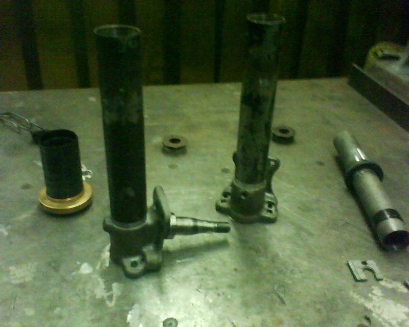

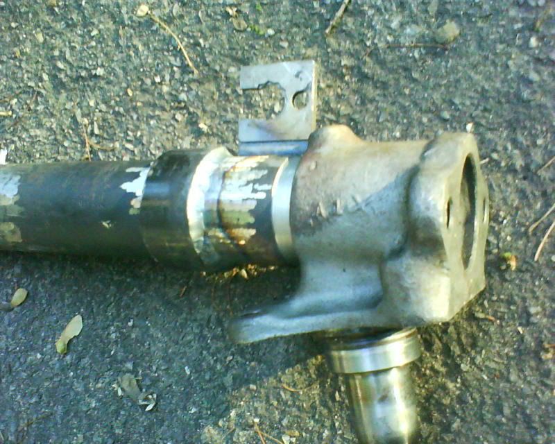

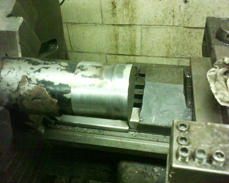

So it took me about 10 to 12 hours of machining to get the new struts done.
I cut the supra strut tubes off the supra struts, made some new end caps for the supra tubes on the lathe out of some mild steel. tiged them on the end.
Then turned the newly capped tube down to make sure it was perfectly round for the press fit into the spindle bottom.
Bored out the spindle bottom to the size that was needed. Press fit the new tubes into the original Rx7 wheel spindles.
Here is the difference in tube height.
Finished product with no paint.
The new struts give me almost 2" extra suspension travel. so the car will be around an 1" lower in the front.

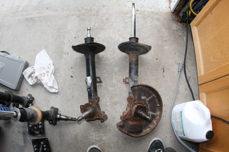

Its been a little while since my last update. I picked up some Koni race inserts for the front. they are a much shorter bodied damper than my illuminas i have on the front. Unfortunately the konis are larger in diameter than the strut tubes on the 7. I did a bit of searching and found that mk2 supras use a similar front strut setup as the 7 and the strut tube body is the right inside diameter to fit the konis.
The front supra struts that i picked up.
the rx7 illumina damper versus the koni race insert.

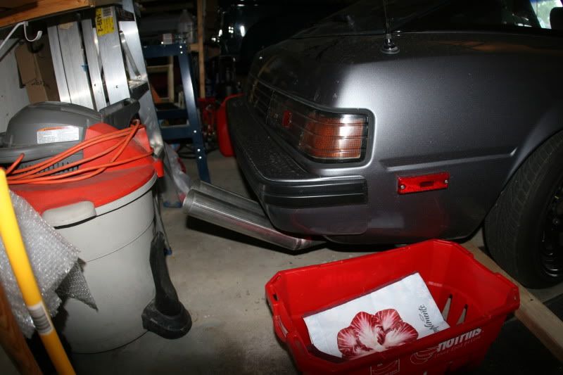

i got bored and decided to make some shotgun pipes for the exhaust.
