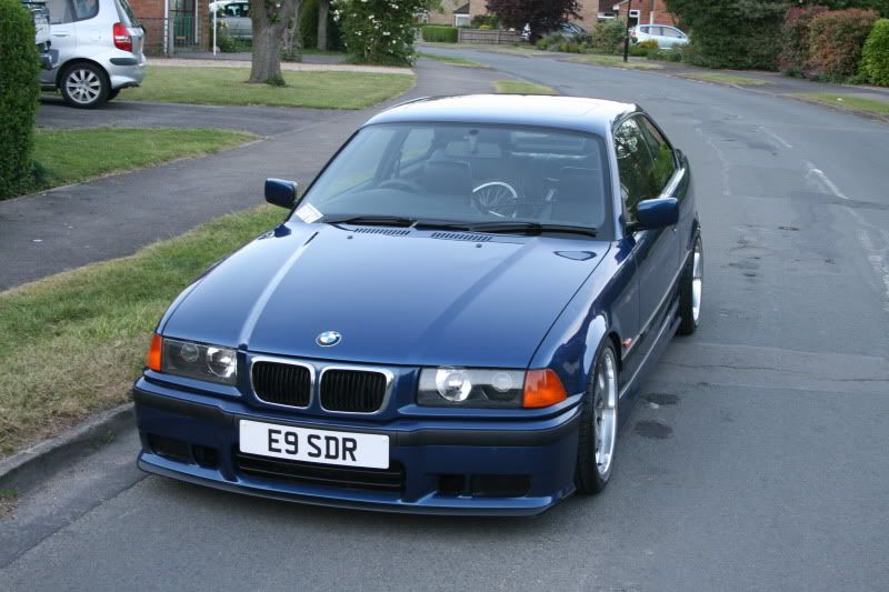

Lots and lots have gone on, heres a up to date timeline

Engine
M52B28
M50 inlet
BBTB
ASC removed
80mm silicone intake pipe
Debaffeled air box with K&N filter
Viscous fan delete
M30 80c Thermostat
M44 80/88c Fan Switch
M3 Evo top mount covers
Transmission
5 speed manual
Hel braided clutch hose
Removed CDV
Z3M short shift
Home made weighted selector lever
M3 3.0 LSD 3.15
Chassis
Hottuning coilovers
Front helper springs removed
Camber adjustable front top mounts
Bilstein Sport rear dampers
Z3 rear top mounts
Eibach ARB front & rear set hard
X-brace
Front upper strut brace
Exterior
4300k HID's ballasts hidden in bumper iron
Delensed headlights with matt black projector shrouds
Amber indicators all round with front day time running lights
Chrome exhaust tips
Front evo lip spoiler
Home made front bumper under tray
Home made fog light blanks
U.S-spec front number plate blanking strip
M3 mesh bumper grill
Rolled and pulled arched
328i badge removed
Aero wiper blades
Personalised number plate
TRS removable tow strap
Wheels & tyres
Summers
E34 M5 Throwing stars 17x8 ET20 & 17x9 ET22
Polished lips, sliver centres & black insides
Eibach 5mm spacer all round with longer bolts
Falken 452 tyres 225-35 & 245-35
Winters
BBS RC041/42 17x7.5 & 17x8.5 ET41
Painted all sliver
Polished centre nut
BBS 3D hologram centre cap black
Front 15mm spacers with longer bolts
Falken 452 235-40 & Pirelli pzero 245-40
Interior
Recaro Pole Position bucket seat
Automac custom side mounts painted black
Custom made seat belt buckle
Drivers Jesus handle
Arm rest removed & replaced with non arm rest centre console
Sparco 300mm suede steering wheel
Driftworks snap off boss
E46 club sport gear knob
Custom extended shift rod
Suede gear & hand brake gaiters
Removed rear head rests
All sound deadening and underlay tar removed
Thinned down wiring loom
Spare wheel, jack, first aid kit & warning triangle holder all removed
Home made boot floor
Cargo net
LED alarm light
Ice
Alpine CDE-111RM iPod head unit, amber illumination
6x9 parcel shelf adaptors
JL Audio Evolution TR690Txi 6x9
JL Audio Evolution TR525Cxi 13cm front foot well speakers
JL A2150 amp hidden in spare wheel on a false floor build (now removed)
JL W0v2 12" sub in JL slot port box (now removed)
