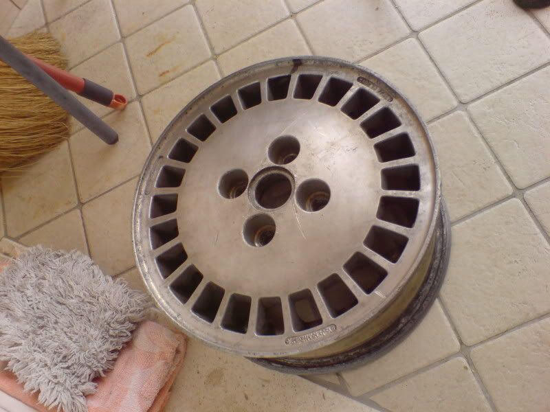

- BWA Sportstar wheels 8J ET5 rear, 6.5J ET3 front (1976, restored)
(I have a thing for four spoke wheels)

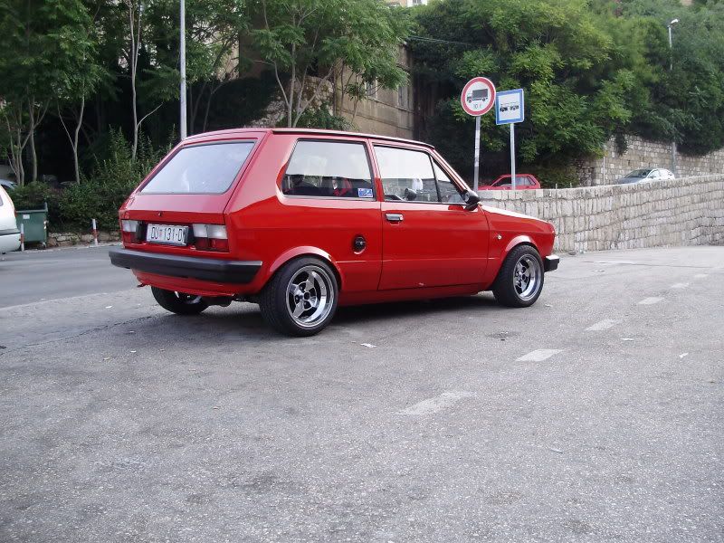

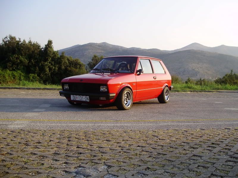

This is how the car looks now...
